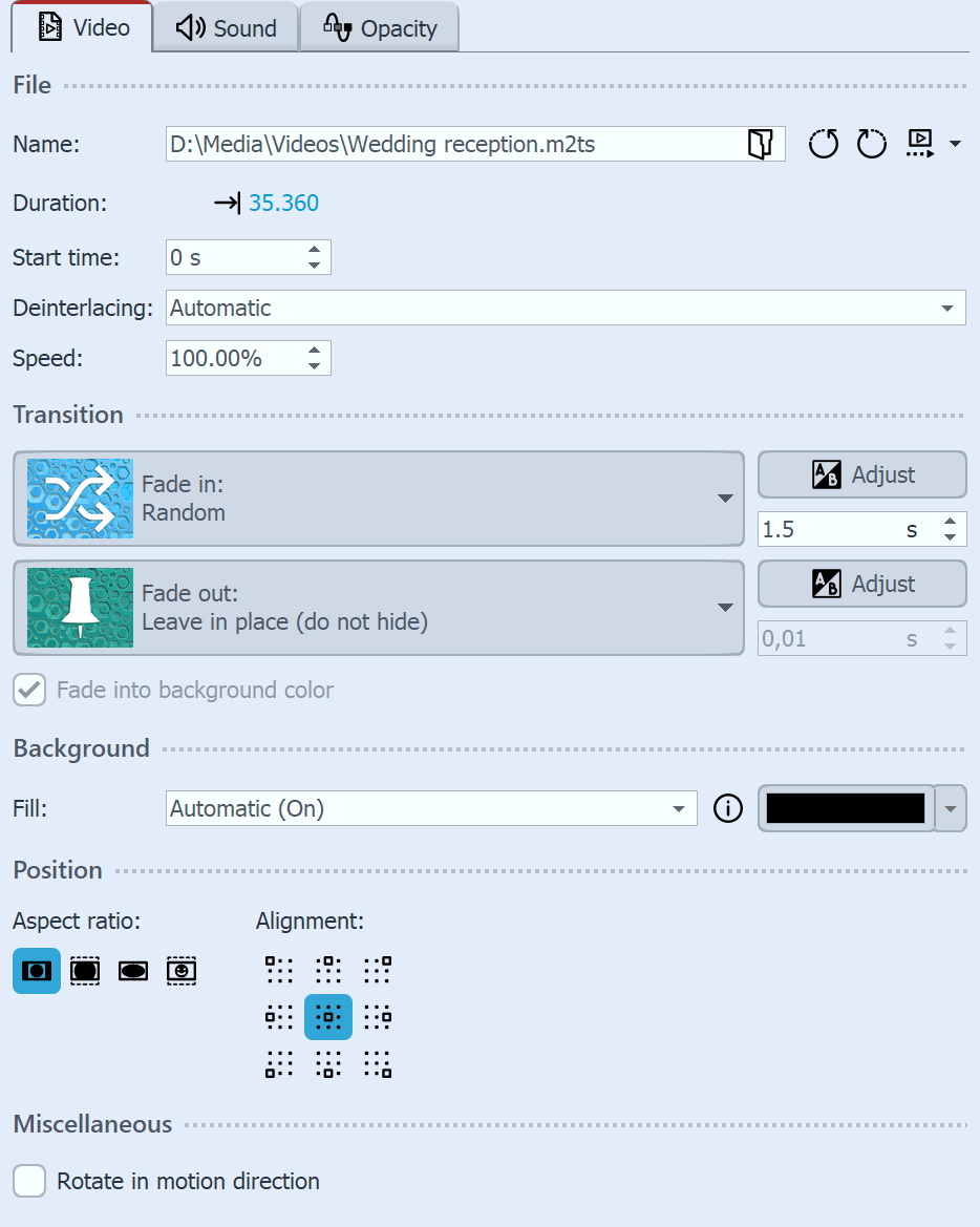

In the Properties window for videos you can find the following setting options.
Name: Shows you the path and file name of your video. You can also swap the video for another video file using the folder icon.
Linksbündig
Rotates the video clockwise.
Zentrierter Text
Rotates the video counterclockwise.
LABBr_Proxy
Calculate/remove proxy video(s)
Duration: Once you have changed the playback time of the video, you can set the original video length again by clicking on the time.
Start time: Here you can enter from which position in the video should be played. For example, if you do not want to see the first two seconds of the video, enter the value "2s" here.
Deinterlacing: Select here from the options Automatic, Off and Always. Activating this option only makes sense if you insert videos that have been recorded in interlaced mode.
Speed: You can specify how fast or slow the video should play in AquaSoft Video Vision and Stages. Values below 100% slow down the playback speed, values above 100% speed up the playback speed.
Speed: You can set the speed in AquaSoft Video Vision) and Stages) to specify how fast or slow the video should play. Values below 100% slow down the playback speed, values above 100% speed up the playback speed.
Fade in: A fade-in and fade-out can be assigned to the video. The crossfade can be configured individually via Adjust.
Fill background:
- On = Background is filled in color if the video does not fill the full display. The background color can be selected under Fill color.
- Off = Background is not filled and the previous object is still visible below the video. If you want to achieve a picture-in-picture effect, enable this option.
- Automatic = The program automatically sets to On for images/videos/flexi collages in the first track. If you move an object to the second or deeper track, it is set to Off. This allows you to create picture-in-picture effects more quickly. If you prefer a fixed value, you can set this yourself with the On and Off options.
Aspect ratio:
The aspect ratio describes the relationship between the height and width of the video. If a video deviates from the aspect ratio of the project, you can decide here how the video should be displayed.
- Keep: The video gets borders while playing.
- Crop: From the edge of the video, parts are "trimmed" until the video fits the correct aspect ratio, without creating borders.
- Stretch: The video is inserted into the aspect ratio of the project, distorting the image.
- Center faces: Faces are taken into account when cropping (face detection) and, if possible, are centered and not cropped.
Alignment: defines where the video should be positioned on the screen.
Rotate in motion direction: If you have assigned a Motion path to the video, you can have the video automatically rotate along the path.
