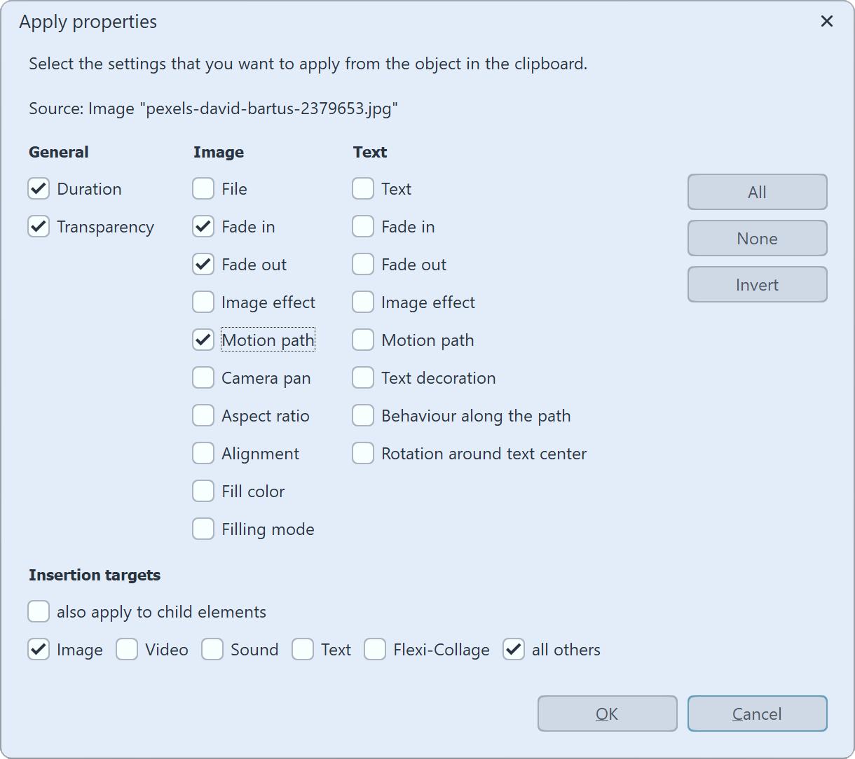

Properties such as transitions, image effects and text animations can be transferred between any objects.
![]() Apply properties 1 Copy the object (for example an image) from which the properties are to be transferred. To do this, select the image in the Timeline and press Ctrl + C . (Or right-click on the image and copy). The object with its properties is now in the clipboard of the computer. 2 To transfer the cached properties, select the object (or several objects) to be modified, right-click on it and select Apply properties. 3 The window shown opposite opens. Activate the properties that are to be transferred from the source to the selected object with a check mark. Select the corresponding insertion target. Confirm your selection with OK. |
The properties transferred in this way are now also available on the selected objects. However, they can still be changed individually on the objects.
For example, to transfer a transition from an image to a Flexi-Collage object, first right-click the image and select Copy. Now click the Flexi-Collage button with the right mouse button and select Apply properties. Select the item Image fade-in and at Paste target Flexi-Collage.

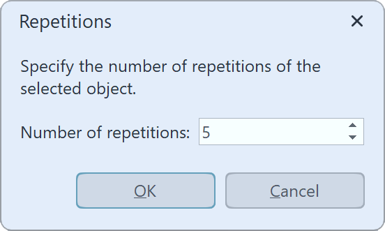

![]() Multiply objects If you want to copy and paste several objects with identical properties repeatedly, a corresponding function is available. Inthis way, even more complex Chapters and Flexi-Collages can be quickly multiplied and pasted one after the other. To do this, select the object to be multiplied and go to Edit / Multiply and specify the number of repetitions you want. |
