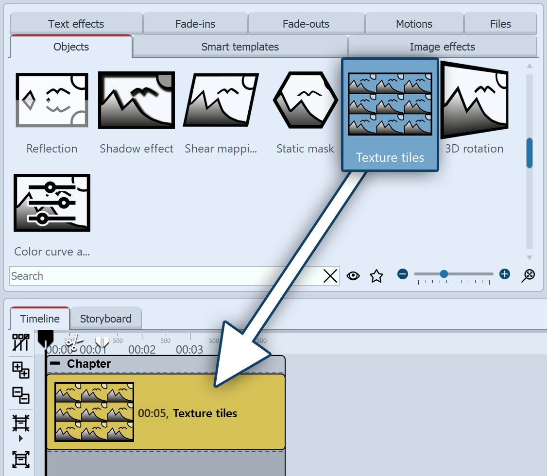

![]() Inserting texture tiles Drag the effect from the Toolbox onto the desired location on the Timeline. Normally the effect is applied as a background. You can insert a chapter first of all and then drag the effect into the chapter. |

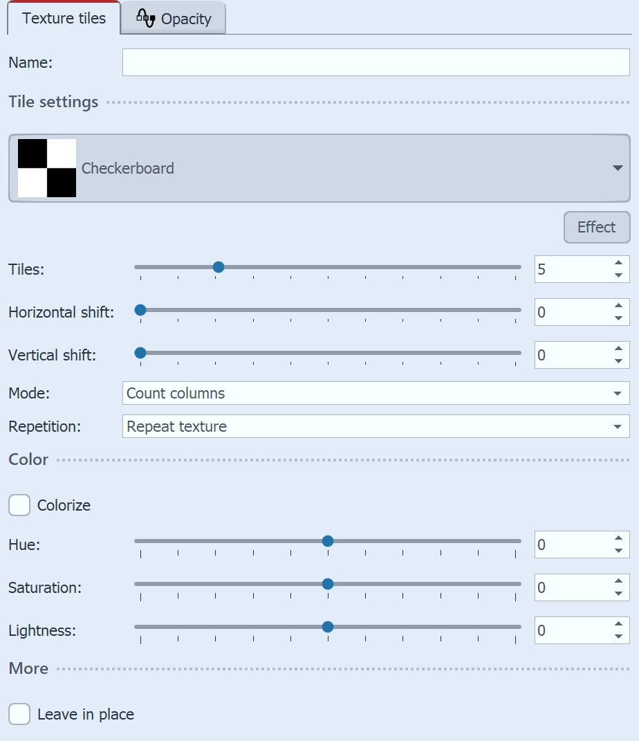

![]() Settings for Texture tiles In the properties field how the effect behaves.
In Stages the effect can also change over time. To do this, click on the Curve icon to make the following selection: •Value (single value that remains the same) •Curve (number of tiles can change over time) Mode
Repetition
Color Change the hue, saturation and brightness of the selected texture. |
