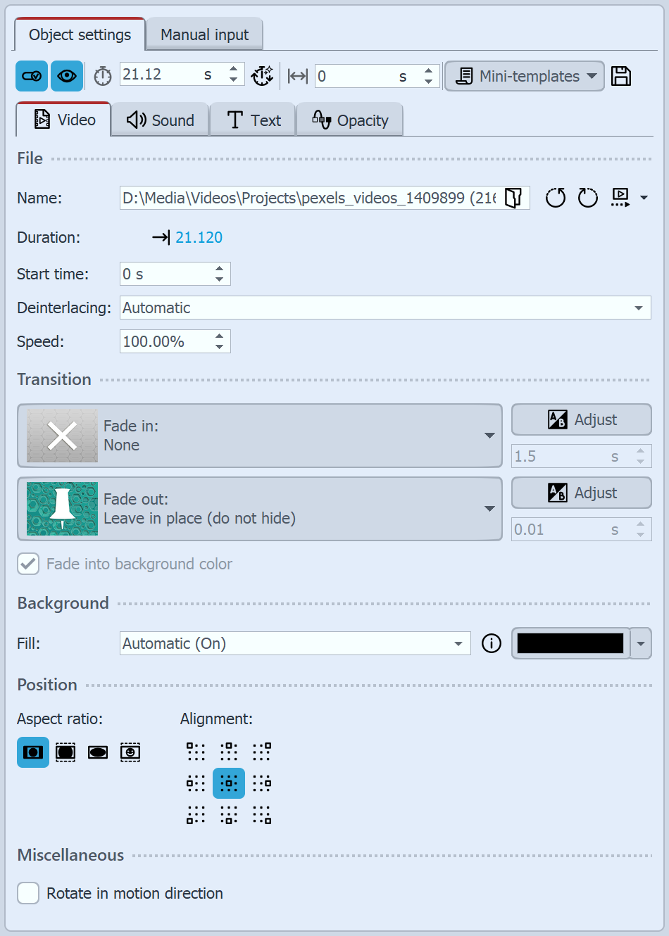

In the Properties window for videos you can find the following setting options.
Name: Shows you the path and file name of your video. You can also swap the video for another video file using the folder icon.
Linksbündig
Rotates the video clockwise.
Zentrierter Text
Rotates the video counterclockwise.
LABBr_Proxy
 VIDEO VISION   STAGES  Calculate/remove proxy video(s)
Duration: Once you have changed the playback time of the video, you can set the original video length again by clicking on the time.
Start time: Here you can enter from which position in the video should be played. For example, if you do not want to see the first two seconds of the video, enter the value "2s" here.
Deinterlacing: Select here from the options Automatic, Off and Always. Activating this option only makes sense if you insert videos that have been recorded in interlaced mode.
Speed: You can set the speed in AquaSoft Video Vision and Stages to specify how fast or slow the video should play. Values below 100% slow down the playback speed, values above 100% speed up the playback speed.
Fade in: A fade-in and fade-out can be assigned to the video. The crossfade can be configured individually via Adjust.
Fill background:
- On = Background is filled in color if the video does not fill the full display. The background color can be selected under Fill color.
- Off = Background is not filled and the previous object is still visible below the video. If you want to achieve a picture-in-picture effect, enable this option.
- Automatic = The program automatically sets to On for images/videos/flexi collages in the first track. If you move an object to the second or deeper track, it is set to Off. This allows you to create picture-in-picture effects more quickly. If you prefer a fixed value, you can set this yourself with the On and Off options.
Aspect ratio:
The aspect ratio describes the relationship between the height and width of the video. If a video deviates from the aspect ratio of the project, you can decide here how the video should be displayed.
- Keep: The video gets borders while playing.
- Crop: From the edge of the video, parts are "trimmed" until the video fits the correct aspect ratio, without creating borders.
- Stretch: The video is inserted into the aspect ratio of the project, distorting the image.
- Center faces: Faces are taken into account when cropping (face detection) and, if possible, are centered and not cropped.
Alignment: defines where the video should be positioned on the screen.
Rotate in motion direction: If you have assigned a Motion path to the video, you can have the video automatically rotate along the path.

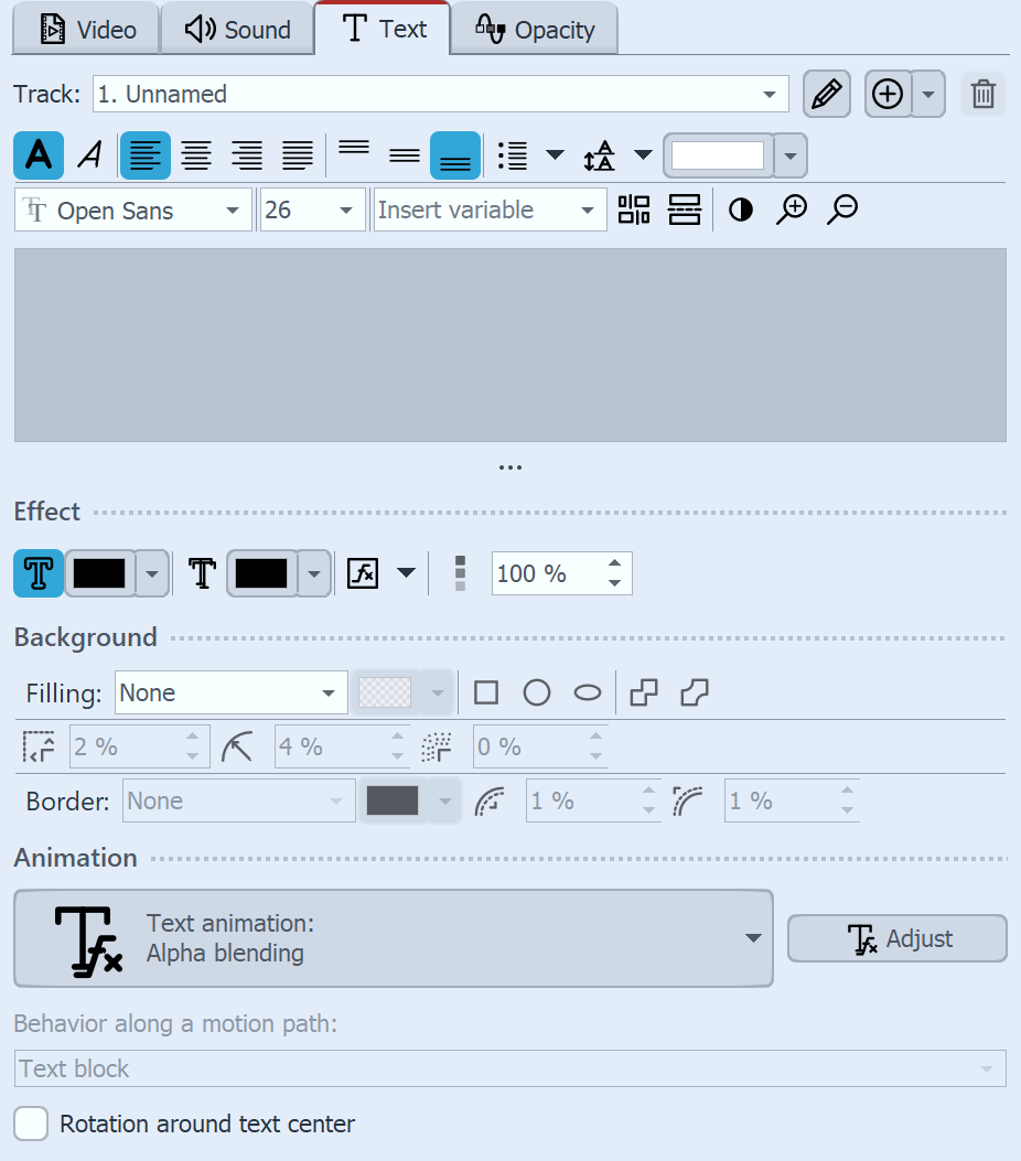

Text (video captions)
Caption of the video
If text is to be displayed while the video is playing, it is stored here.
 VIDEO VISION   STAGES  You can use the track selection to store various text information on a video object. This can be, for example, labels in different languages or an automatic transcription. The track name is used for orientation.
Linksbündig
Edit track names
Zentrierter Text
New track / Transcribe new track automatically / Load new track from file...
Bin
Remove track
Only one text track can be displayed when playing the video object.
If a text is inserted in the text field, it is displayed for the entire duration of the object. If you do not want this, you can work with Text timing or alternatively Label the video with a text object.
The detailed setting options for text design can be found in the Text object properties chapter.
