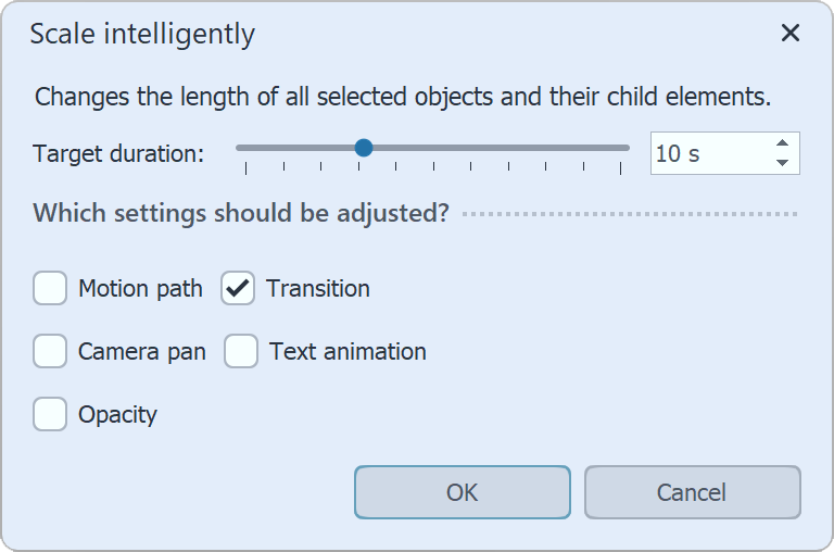

Intelligent scaling
Intelligent skalieren
Use this function to change the display duration of objects and adjust transitions, motion paths, transparencies, camera pans and text animations.  VIDEO VISION   STAGES
The playback speed of sounds and videos can also be adjusted to a new duration, allowing videos and sound to be played faster or slower.
First select the object to be adjusted in the Timeline. This can also be a chapter object or a Flexi-Collage.
Then click on the Intelligent scaling icon. Enter the new target duration and specify which property of the selected object should also be adjusted.
There are constellations where it is difficult to recognize how large the value for the new total duration of the content to be scaled must be, for example the area between two marking lines. To help, insert a placeholder object and drag it to the required duration in Timeline. Then read the properties of the placeholder to find out what the new target duration must be. Then remove the placeholder object again.

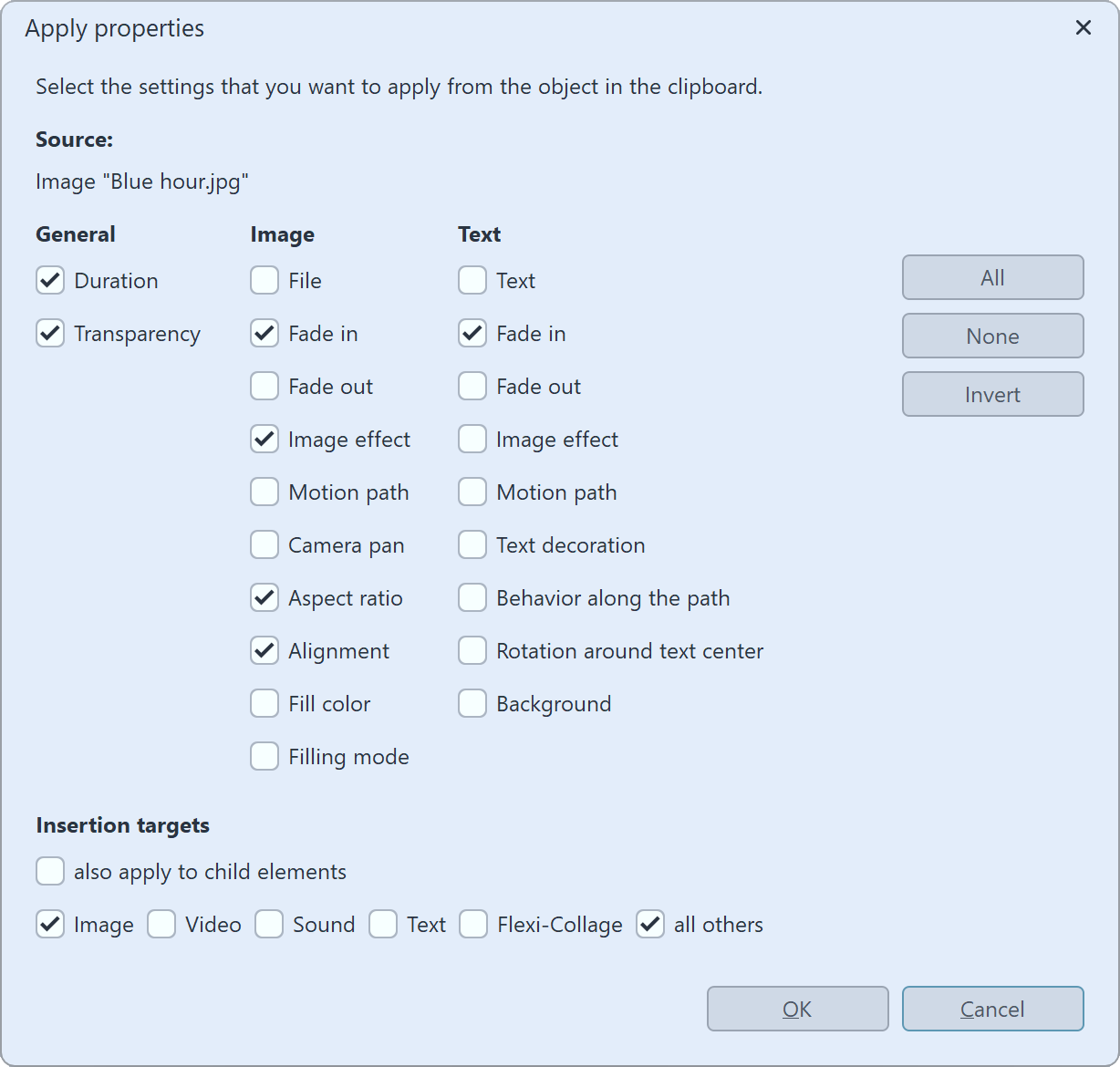

Apply properties  VIDEO VISION   STAGES
Properties such as transitions, image effects and text animations can be transferred between any objects.
Apply properties
Apply properties
1 Copy the object (for example an image) from which the properties are to be transferred.
To do this, select the image in the Timeline and press  Ctrl  +  C . (Or right-click on the image and copy). The object with its properties is now in the clipboard of the computer.
2 To transfer the cached properties, select the object (or several objects) to be modified, right-click on it and select Apply properties.
3 The window shown opposite opens. Activate the properties that are to be transferred from the source to the selected object with a check mark. Select the corresponding insertion target. Confirm your selection with OK.
The properties transferred in this way are now also available on the selected objects. However, they can still be changed individually on the objects.
For example, to  transfer a transition from an image to a Flexi-Collage object, first right-click the image and select Copy. Now click the Flexi-Collage button with the right mouse button and select Apply properties. Select the item Image fade-in and at Paste target Flexi-Collage.

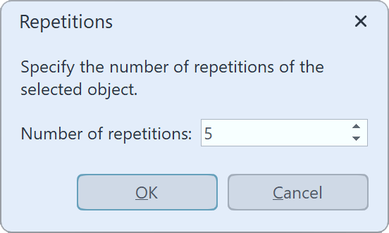

Multiply objects
Multiply objects
Multiply objects
If you want to copy and paste several objects with identical properties repeatedly, a corresponding function is available. Inthis way, even more complex Chapters and Flexi-Collages can be quickly multiplied and pasted one after the other.
To do this, select the object to be multiplied and go to Edit / Multiply and specify the number of repetitions you want.
