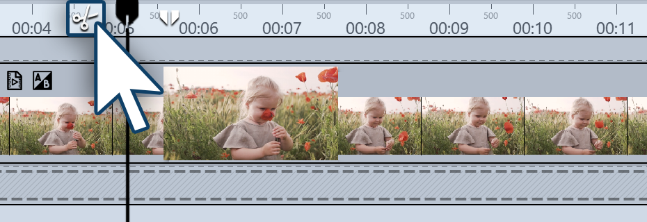

1.1 Cut using the Scissors icon
At the left of the Playhead you will see a Scissors icon. With this you can cut the selected video at the point where the Playhead is located.
After the cut, you will have two video objects. You can now select an unnecessary video part and remove it with the  DEL  key on your keyboard or by right-clicking.

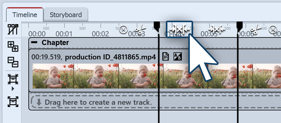

1.2 Remove a part of the video
With the Tweezer icon you can specify a starting point and an end point. The section between the two points is removed from the video by clicking the Cut symbol (an X between two arrows).
Clicking on the front or rear Scissors symbol of the split Playhead, will cut at the respectively appropriate point. If you want to return to the simple Playhead, click the encircled Close icon.
Cutting a piece out from the middle
The section between the two Playheads is removed from the video when you click on the cut symbol (an X between two arrows). Please note that the video object to be cut must be selected in the Timeline.
If you click on the front or rear Scissor symbol on the split Playhead, the cut is made at the corresponding point.
If you want to return to the simple playhead, click on the Close symbol (cross in the circle).

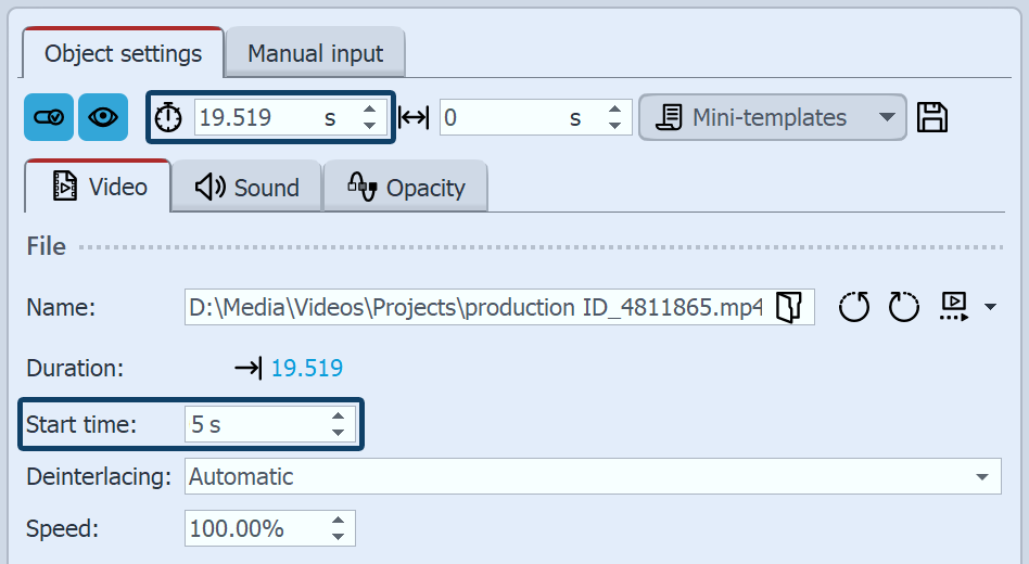

2 Cut videos in the properties window
Shortening the beginning and end of the video
You can shorten the beginning and end of a video directly via the time entry in the Properties window.
Enter the desired length of the video in the Duration field if you wish to shorten the end of the video.
Via Start time enter the time value at which the video should start. (This is the time by which the beginning of the video is reduced.)
