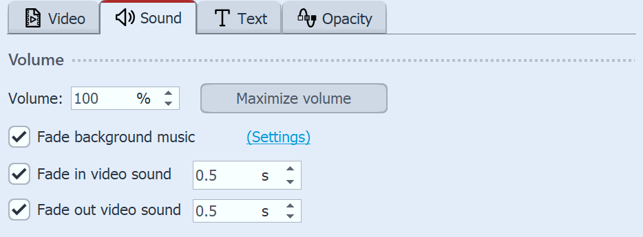

Sound (Video sound)
Sound of the video
Sound of the video
Here you can specify whether the background music should be faded while the video is playing.
If the video has no sound of its own, but may have recorded noise, set the volume of the video to 0% and uncheck Fade background music. This way, existing background music will play while the video is running without lowering the volume.
If the checkmark is set at Fade background music, existing background music will be faded (turned down) according to the music settings while the video is running.
Clicking the Maximize volume button raises the volume for the complete video sound of the object so that the loudest part corresponds to 100%.
For Fade in video sound and Fade out video sound, enter the duration for which the video sound is to be slowly faded in or faded out. Activate/deactivate the function with the check mark.
In AquaSoft Stages, the volume can also be edited directly in the Keyframe track of the video.

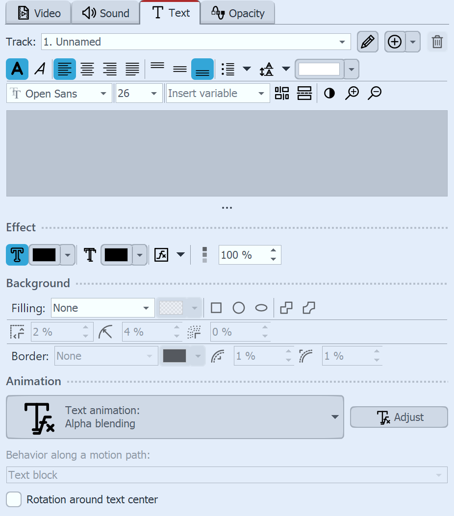

Text (video captions)
Caption of the video
If text is to be displayed while the video is playing, it is stored here.
 VIDEO VISION   STAGES  You can use the track selection to store various text information on a video object. This can be, for example, labels in different languages or an automatic transcription. The track name is used for orientation.
Linksbündig
Edit track names
Zentrierter Text
New track / Transcribe new track automatically / Load new track from file...
Bin
Remove track
Only one text track can be displayed when playing the video object.
If a text is inserted in the text field, it is displayed for the entire duration of the object. If you do not want this, you can work with Text timing or alternatively Label the video with a text object.
The detailed setting options for text design can be found in the Text object properties chapter.
