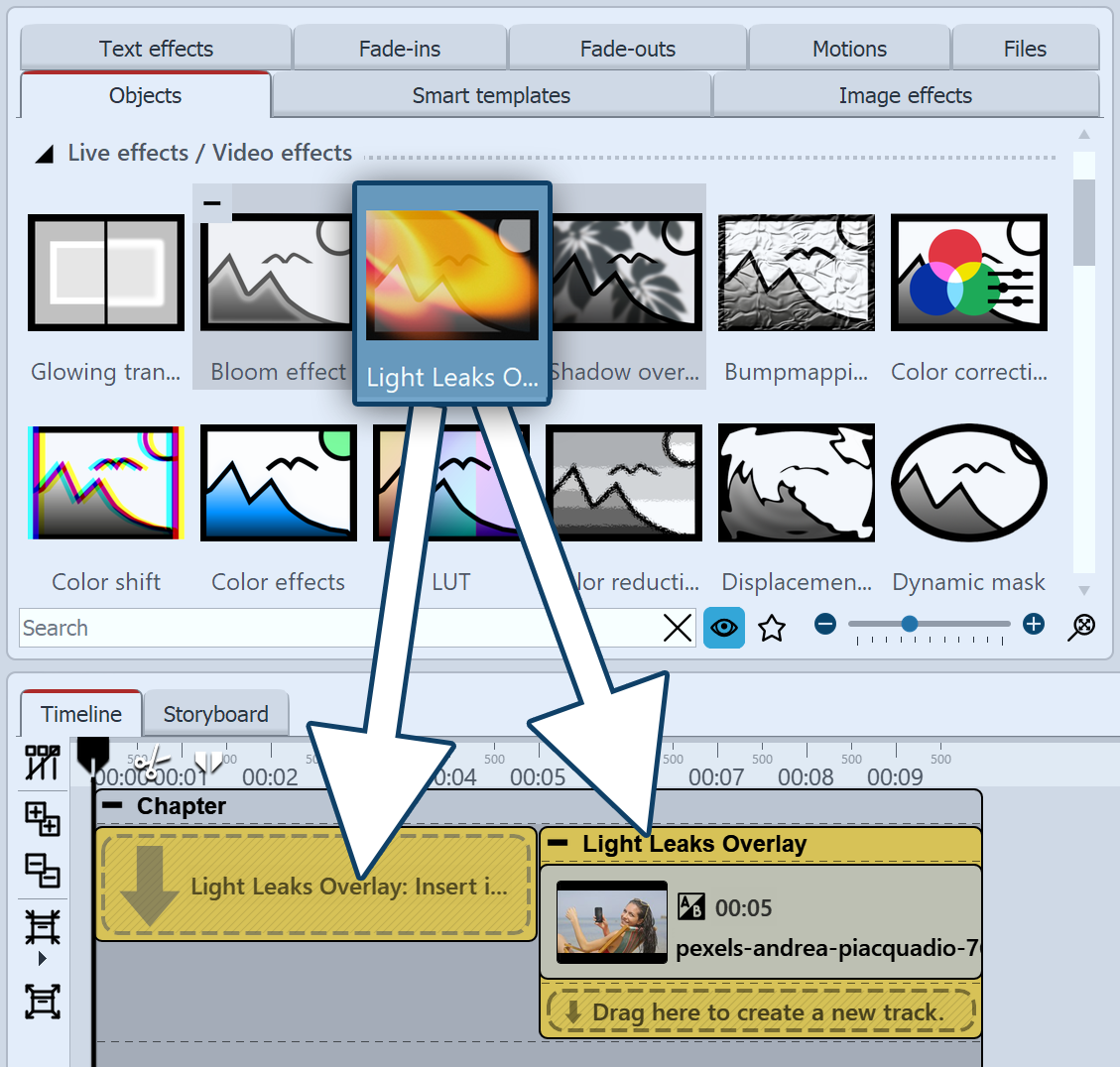

1 Insert the Light Leaks Overlay  VIDEO VISION   STAGES
Insert Light Leaks Overlay
To use the effect, you can  drag it directly onto an image in the Timeline.
You can also drag the effect to the Timeline and later insert one or more images into the effect.
After you insert the image, a colored frame with the title of the effect appears around the small preview image in the Timeline. When you click the colored frame, you can specify the settings for the effect in the Properties area.

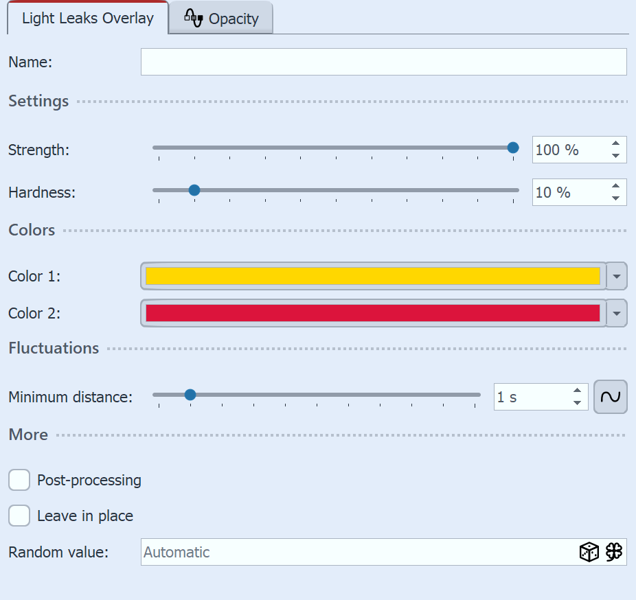

2 Specifying the effect settings
Settings for Light Leaks Overlay
In the Properties area  you can now define the settings of the effect.
Use Strength to select how strongly the light effects overlay the image.
You can change the appearance of the light spots with the Hardness: a low hardness ensures soft spots, a high hardness ensures stronger contours.You can change the appearance of the light spots with the hardness: a low hardness ensures soft spots, a high hardness ensures stronger contours.
You can use the Color selector to change the color of the light spots and make them particularly suitable or particularly contrasting to your motifs.
How often the light spots appear during the display duration of the effect is determined by the setting of the Minimum distance between the fluctuations. The greater the minimum distance, the less frequently a light reflection appears.
 STAGES  To make the effect appear after an irregular time pattern, you can animate the minimum distance with a curve.
