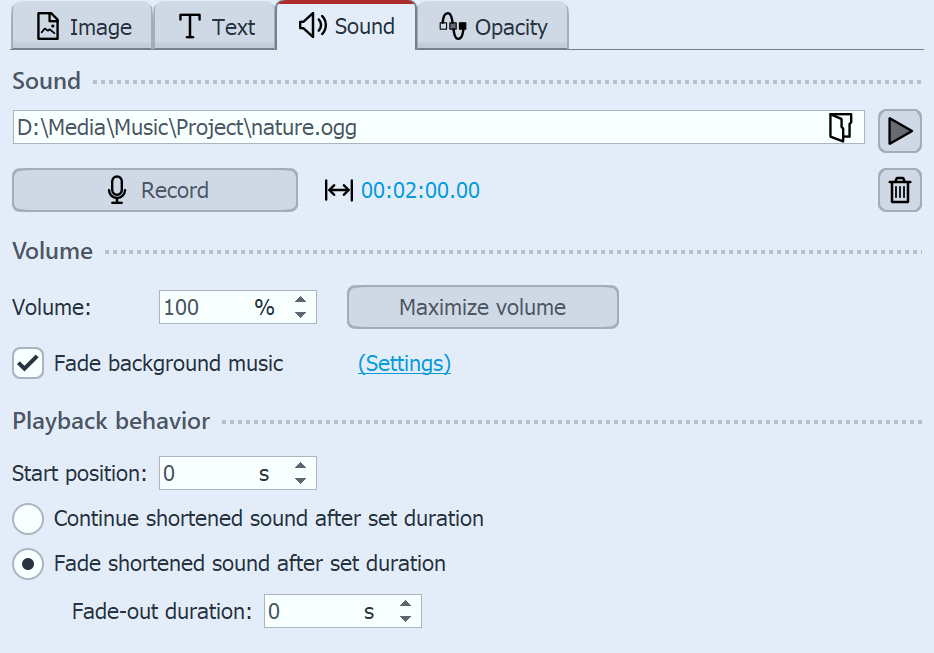

Sound (commentary on the picture)
Adding or recording sound for an image
If the image is associated with a sound or you want to add a sound, you can specify the settings here.
FolderOpen sound file and assign to the image
PlayPlays the associated audio file.
BinRemoves the file name (does not delete the file itself)
Btn_RecordSoundOpens the Sound Wizard, which allows you to record your own comments to the image.
Duration: By clicking on Duration, you can adjust the display duration of the image to the duration of the sound.
Volume: Determines the playback volume of the sound.
Maximize volume: The volume of the stored sound is increased until the loudest part corresponds to 100%.
Fade background music: You can determine whether, while the sound is playing, the background music volume should be faded down/down. This can prevent spoken commentary from being drowned out by the background music.
Start position: If you do not want the stored sound to be played from the beginning, you can "trim" it by entering a value at the beginning.
Continue shortened sound after set duration: With this option, the image can have a shorter duration than the sound. The sound will continue to play over the coming frames until it is finished.
Fade shortened sound after set duration - Even if the sound duration is longer than the image duration, the sound will be faded out together with the image.
