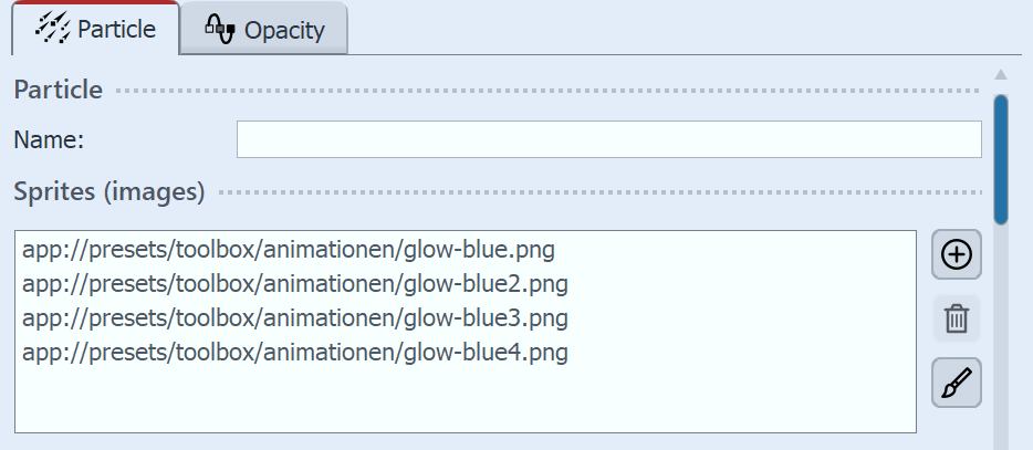

Icons
Props_Particle_1
Btn_Plus
Use this icon to insert graphics into the Particle object. For the particle object to work, you must have inserted at least one image here. These images are called Sprites in the following. If you insert multiple Sprites, either one of them will be randomly selected per particle, or an animation will be created from it. You can set more precise settings with the Sprite animation option. Particularly well suited are cropped images with irregular outlines as sprites.Use this icon to insert graphics into the particle object. For the particle object to work, you must have inserted at least one image here. These images are called sprites in the following. If you insert multiple sprites, either one of them will be randomly selected per particle, or an animation will be created from it. You can set more precise settings with the Sprite animation option. Particularly well suited are cropped images with irregular outlines as sprites.
Btn_Trashbin
Select an image from the list of sprites and delete it by clicking on this icon.
Btn_EditImage
You can apply one image effect to the sprites. The one effect is applied to all sprites together.

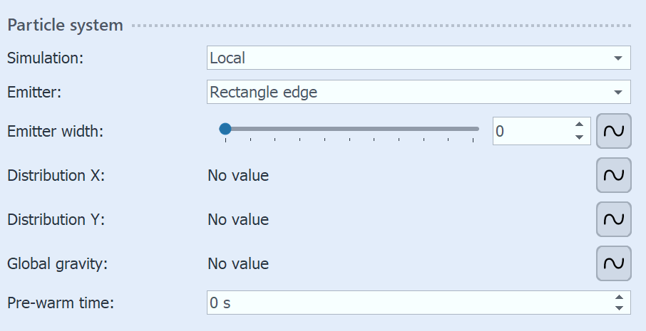

Particle system
Props_Particle_2
Simulation
Only if the particle object has a motion path, the change of the simulation type has an effect.
Local - The individual particles remain in the coordinate system of the particle object after their creation and move together with it.
Global - Particles originate at the current position of the particle object, but are detached from it afterwards and fly their own path.
Emitter
Sp Specify here the position or shape where the particles are created.
Rectangle edge - the particles originate at the outer edge of the particle object and move to the opposite side. From which edge the particles come determines the direction.
Whole area - The entire rectangular area of the particle object is possible place of origin of the particles.
From point - The particles are created only in the center of the particle object. The size of the point can be expanded to a circle with the setting of the Emitter width.
Along the path - If this option is used, the particle object's motion path is used like a drawing. The particle object now remains still and the particles are created evenly distributed along the entire path. The Emitter width can be used to control the area around the motion path in which the particles are allowed to form.
Emitter width
see Emitter
Distribution X/Y
The location of particle formation can be distributed to specific areas on the X/Y axis using a curve.
Global gravity
The particles are deflected from their position and fall down faster or slower depending on the set value.
Pre-warm time
If the particle system has to settle in before it is to be displayed, you can specify here the time that the system is pre-simulated invisibly before it is displayed. The time specified here is not part of the presentation.

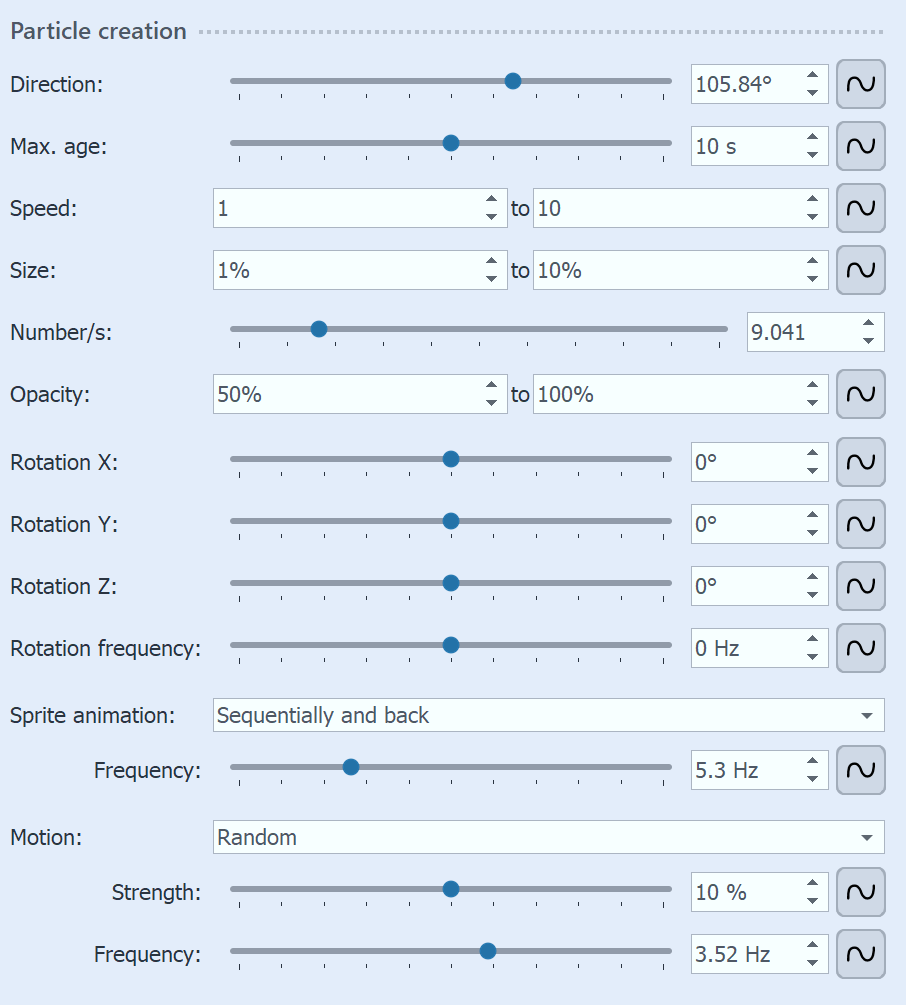

Particle creation
Props_Particle_3

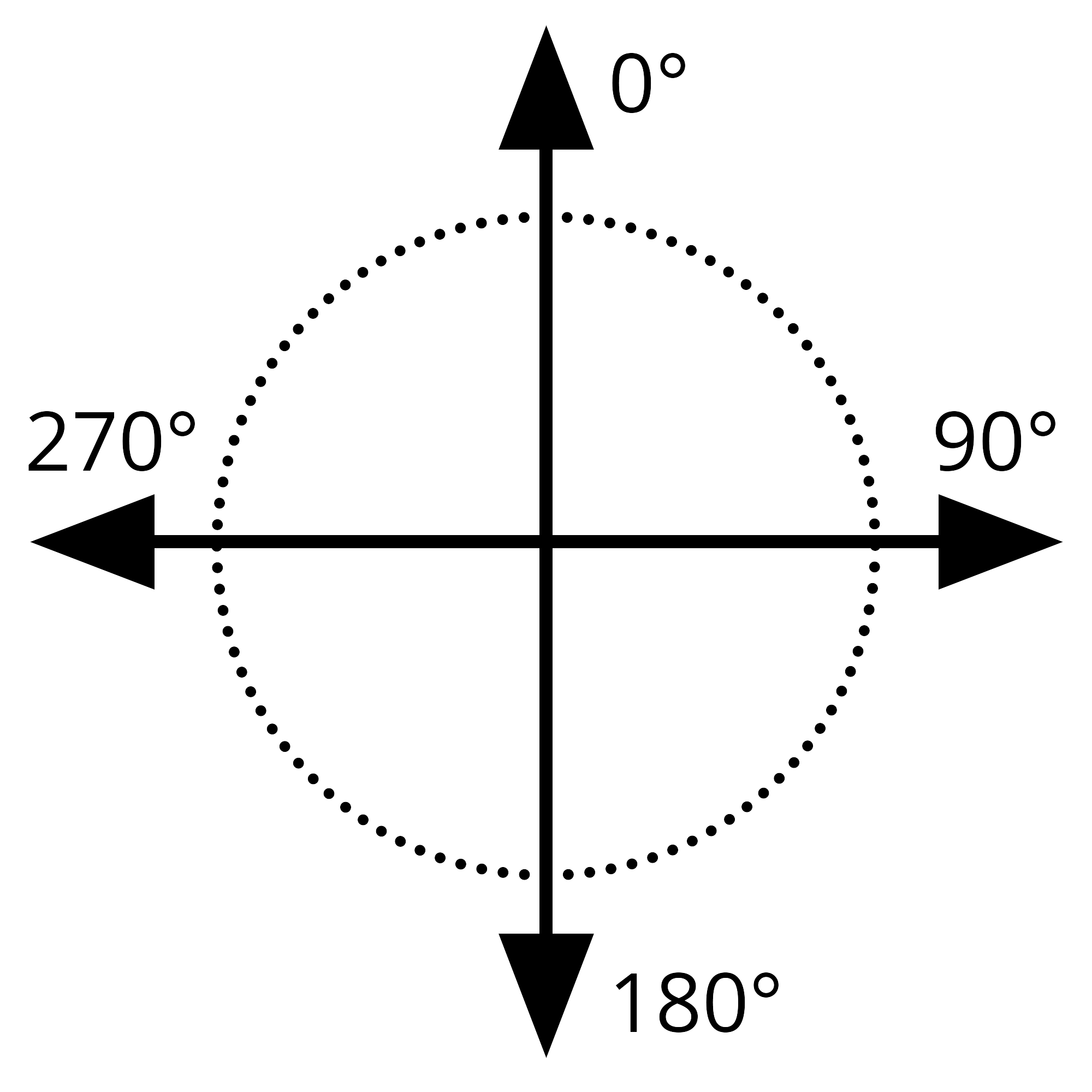

Direction
Diagram_Circle_ZeroOnTopHere you can set the direction in which the particles fly. The graphic (right) shows the meaning of the values.
Max. age
A particle has an adjustable lifetime. If a particle should disappear after e.g. two seconds, enter this time here.
The time 0 has a special position. It causes that the single particle lives as long as the whole particle object.
The particle lifetime  is the reference value for all settings concerning the particle life.
Speed
You set the speed of the movement under Speed. The higher the value, the faster the particles fly across the screen. A value of 0 means no speed. The particles then remain where they were created. The speed is given in "virtual screen units per second". Thereby 1000 corresponds to the complete screen size. A value of 1000 means that the particle flies over the entire screen within one second.
Size
Here you determine the size of the particles. The size is calculated based on the position frame in the Layout designer. If the position frame is at its full size in the Layout designer and the particle size value is set to 10%, the particles have 10% of the size of the position frame. If you reduce the size of the position frame, the particles become smaller relative to it. Here it often makes sense to set a range of values instead of a fixed value in order to bring more variation into the particle system.
Number/s
With the Number you set the amount of new particles to be created per second. Together with the maximum age of a particle, this results in the number of particles visible at the same time. Note here that more particles also require correspondingly more computing power.
Opacity
Specify here how opaque a particle should be when it is created. As with size, it is often useful to enter a range of values for Opacity in order to create variations, e.g. for snowflakes, whose size also varies in nature.

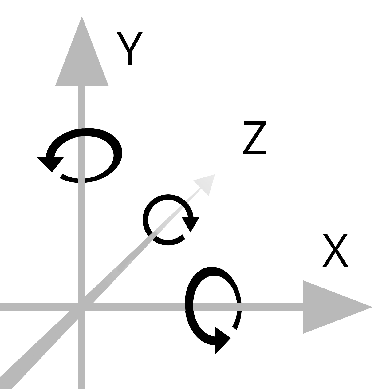

Rotation X/Y/Z
Diagram_3DA particle is a 2D graphic in 3D space. It can therefore be rotated around all 3 axes. This is the initial rotation, so it is not an animation.
Rotation frequency
Rotation speed around the Z axis (animated).
Sprite animation
The setting is only useful if at least two different sprites have been added.
none - For each new particle, one of the available sprites is randomly selected and not changed over time.
Random - Over the lifetime of the particle, the sprite used changes regularly. One is randomly selected from the list of available sprites.
Sequentially - All sprites are displayed one after the other. When you reach the last one, the first one starts again.
Sequentially and back - Like Sequentially, but after the last sprite the list is not repeated, but worked backwards to the first sprite.
Use the Frequency to set how often the Sprites change (does not apply to Sprite animation "none"). The specification of 0 represents a special case here: In this case, the animation of all Sprites takes place exactly once in the lifetime of the particle.
With the help of the particle option Blend sprites the change of the Sprites does not take place abruptly but the particles blend smoothly into each other.
Motion
Each particle flies a certain path. Via the movement you can specify a deviation from this path without actually redirecting the particle, i.e. the particle always returns to its original path. Several movements are available:
none - no deflection of the particle
Wave oscillation (sinus waves) - The particle performs a wave-like motion along its path.
Circular motion - The particle describes small complete circles around its orbit.
Random - The particle is randomly deflected perpendicular to its path.
Randomly in all directions - The particle can be randomly deflected in any direction on the surface.
Random 3D - Deflection occurs randomly in any direction, also modifying the depth in space.
Strength
Here you set how strong the deflection from the original path of the particle should be. The higher the number, the more the movement strength increases. The strength depends on the size of the particle.
Note: With the "random" movements, the movement strength must often be increased for the desired effect, since the strength only indicates the maximum deflection, but on average only smaller deflections are flown.
Frequency
The frequency indicates how often the movement is performed. The higher the number, the faster and more frequent the movements.

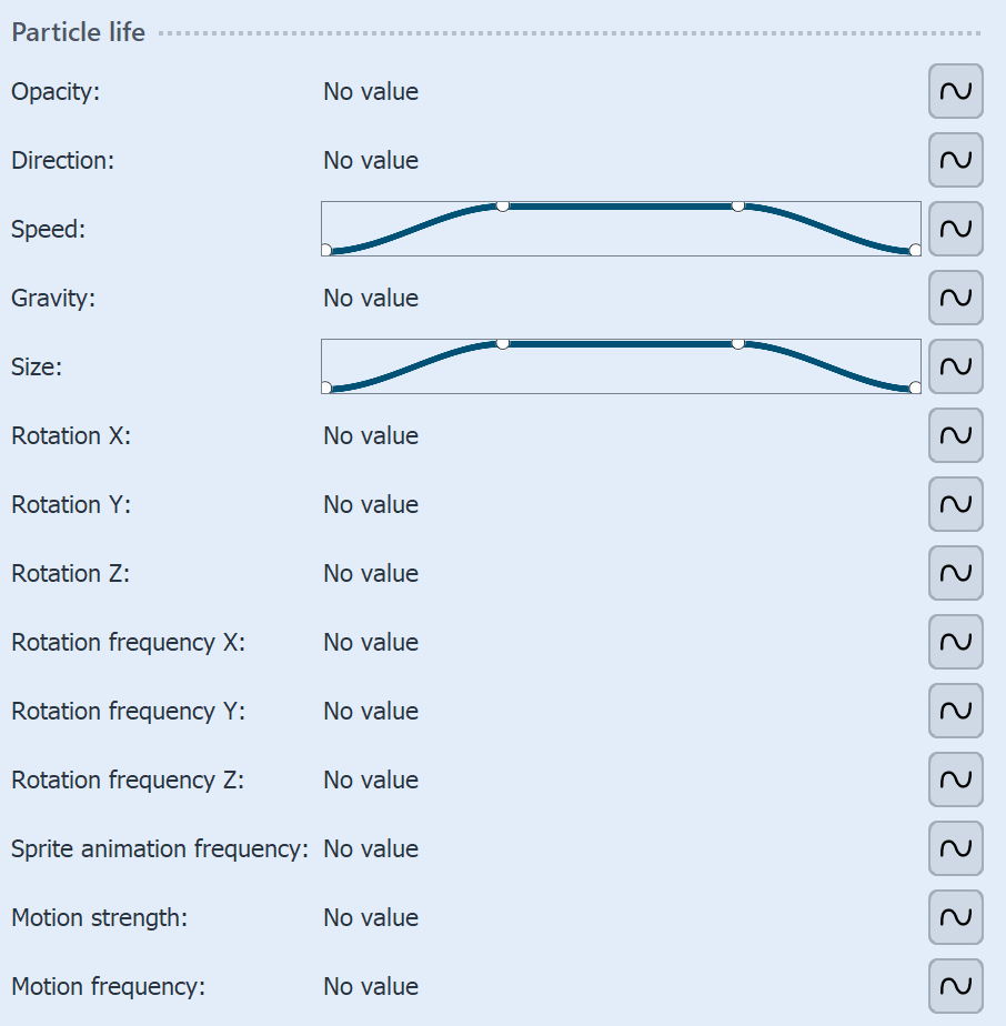

Particle life
Props_Particle_4
All values can be entered as a single value or as a curve. With the curve, the values change over time.
All values here are relative to the initial values when a particle was created. For example, if a particle was created with an opacity of 50%, 100% opacity of the particle life setting corresponds to this value of, say, 50%.
Opacity
Modifies the Opacity of the particle. For example, if a particle is to fade out discreetly at the end of its life, enter a curve here that is 100% at the beginning and 0% at the end.
Direction
Deflection of the particle's flight direction over time. In contrast to the setting of the movement, the particle leaves its original trajectory here permanently. Enter here e.g. 10° to deflect the particle by 10° clockwise from its original trajectory. Here it makes more sense to specify a curve.
Speed
Modifies the speed of the particle. For example, to accelerate a particle, enter a curve from 0% to 100% here. At the end of its lifetime, the particle will then have reached the velocity that was specified when the particle was created.
Gravity
Size
Modifies the size of the particle. For example, so that a particle becomes smaller at the end of its life and disappears into nothingness, specify a curve here that goes from 100% to 0%. Often the effect is combined with a reduction of the opacity.
Rotation X/Y/Z
Diagram_3DRotation of the particle sprites around the corresponding axes. The rotation angle is added to the current rotation angle of the particle.
Rotation frequency X/Y/Z
Frequency of rotation around the respective axis. This value is given in % and modifies the initial value. It therefore only has an effect if a value greater than 0 was specified under the rotation frequency during particle formation.
Sprite animation frequency
Modifies the value of the initial animation frequency, which must be greater than 0 for an effect to be visible.
Motion strength
Modifies the initial motion strength.
Motion frequency
Modifies the initial motion frequency.

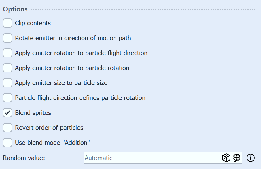

Particle options
Props_Particle_5
Clip contents
Cuts off everything that is not in the frame of the particle object. The setting is usually only useful for local simulation.
Rotate emitter in direction of motion path
If a motion path is assigned to the particle object, the entire particle object and thus the emitter rotates in the direction of travel of the motion path.
Apply emitter rotation to particle flight direction
If the emitter is rotated using a motion path, newly created particles are assigned this direction as their flight direction.
Apply emitter rotation to particle rotation
If the emitter is rotated using a motion path, the particle sprites are rotated in the same direction.
Apply emitter size to particle rotation
The change in size of the emitter affects the change in size of the particles.
Particle flight direction defines particle rotation
The particle sprites align themselves with their trajectory.
Blend sprites
If a sprite animation is selected and there are multiple frames for a particle, they will be smoothly blended.
Reverse particle order
New particles appear in front of or behind the old ones.
Use blend mode "Addition"
Meeting particles change their brightness and "glow".
Random value
Particle generation can be made exactly repeatable via a random value.
