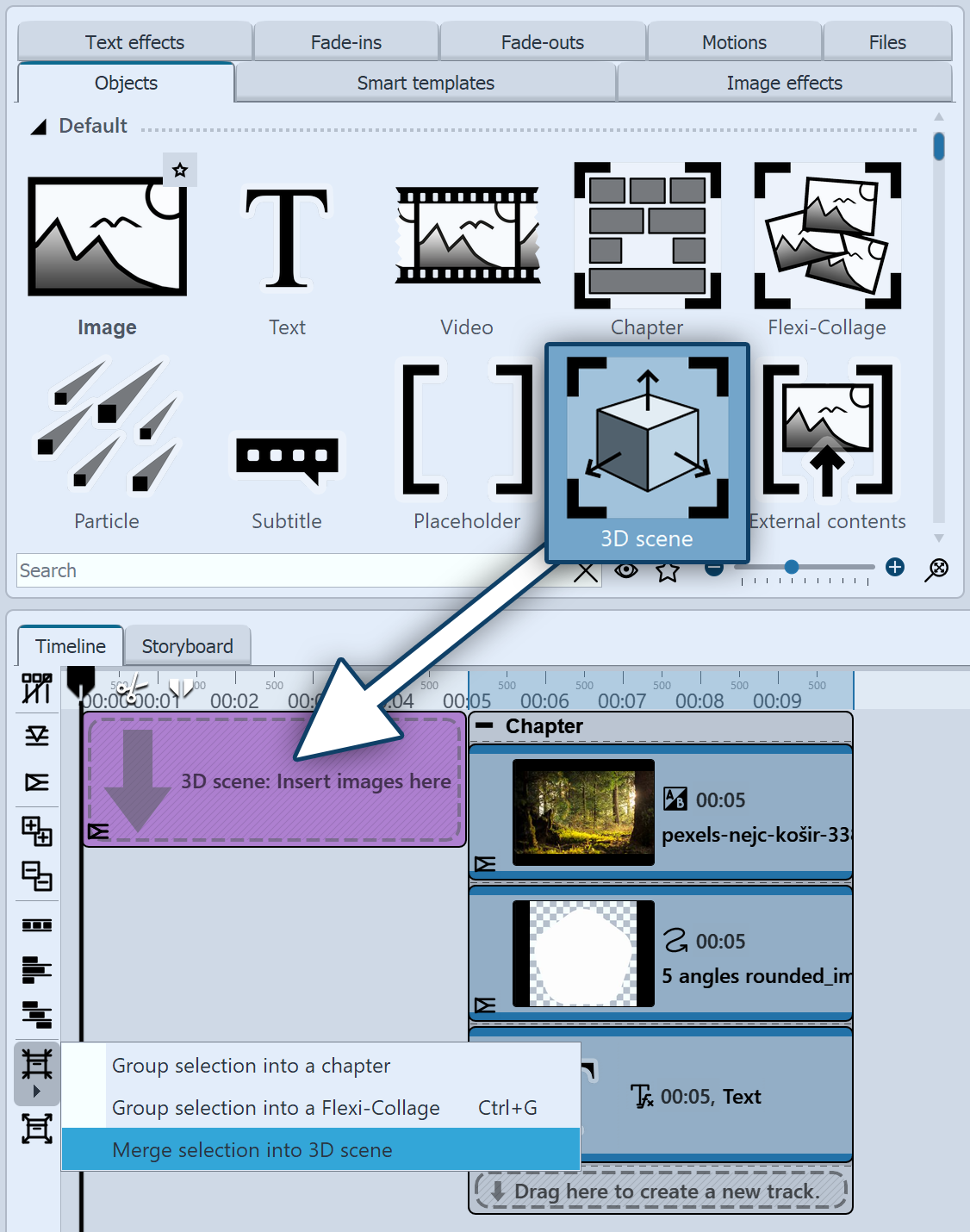

1 Using the 3D scene object
![]() You can also select one or more objects in the Timeline and use the Merge icon on the left edge of the Timeline to merge the selection into 3D scene. |

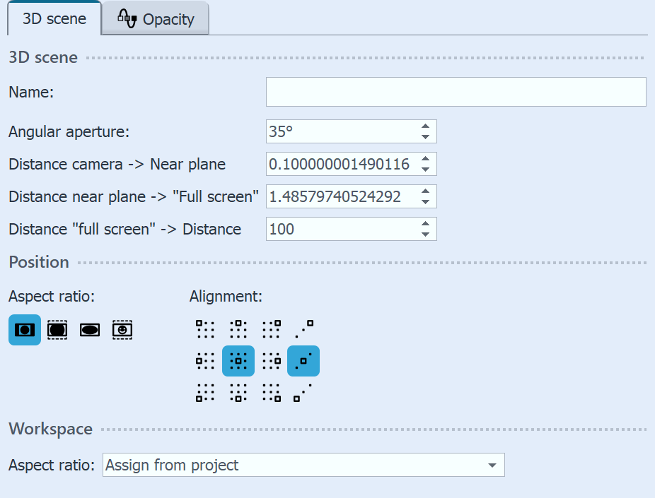

![]() Properties of the 3D scene Select the 3D scene object in the Timeline to see its properties.The workspace for the 3D scene is determined by the project aspect ratio X:Y:Z. The value for Z is derived from the shorter side of the aspect ratio. However, the 3D scene can also have its own aspect ratio. To do this, select the setting Own for Aspect ratio. With the setting Automatic, the aspect ratio of the parent element (of another 3D scene or a Flexi collage) is adopted. In the Layout designer, as soon as you view an object within the 3D scene, the workspace is visualized by a bright area on the bottom. |

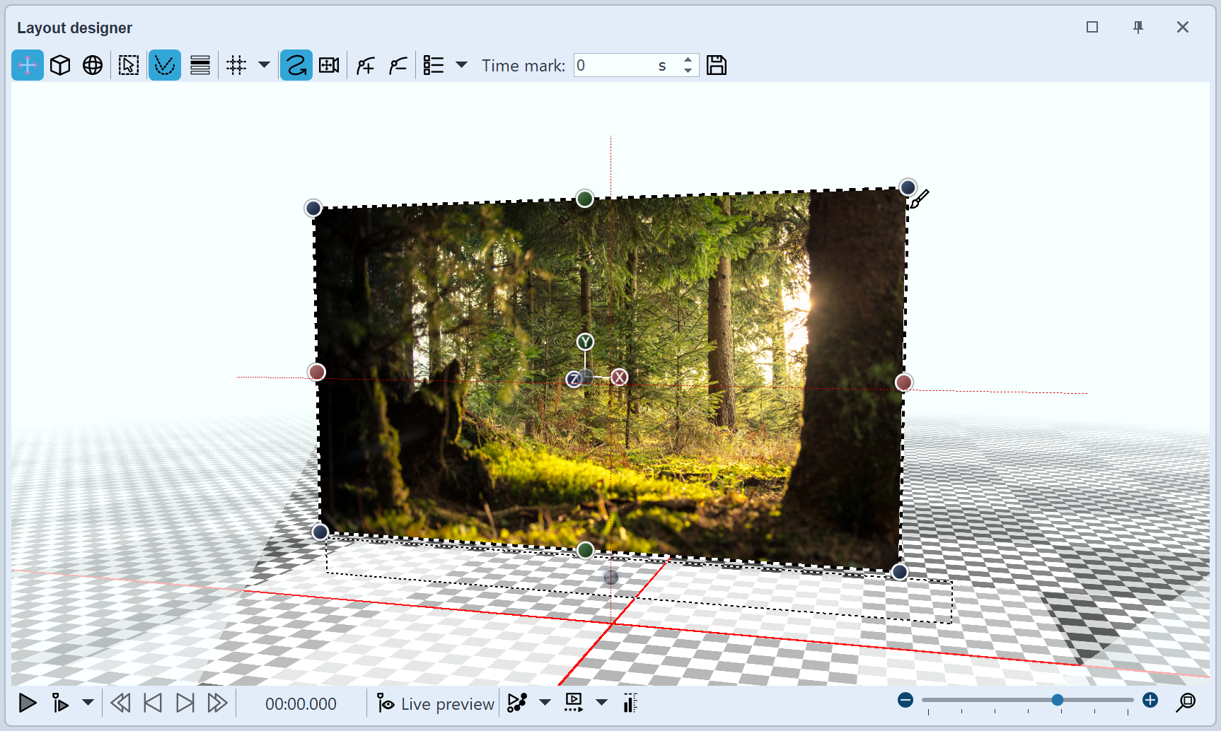

![]() Format-filling image in 3D scene The position of the image in 3D space results from the X, Y and Z coordinates. For this purpose, rotation on the X, Y and Z axes (as well as combinations) is possible . In the 3D space, the position X=50 / Y=50 / Z=50 is displayed with red marking lines. To change the values for position, rotation or object size directly by numerical input, open the Manual input. You can also change the size, position and rotation of the object directly in the Layout designer. The following icons are available at the top left of the Layout designer for this purpose:
Select the mode and then click on the object whose 3D properties are to be changed. Use the X/Y/Z handles to implement the respective change or move the object directly with the mouse. For resizing, you can also use the colored handles on the dashed selection frame of the object. |
