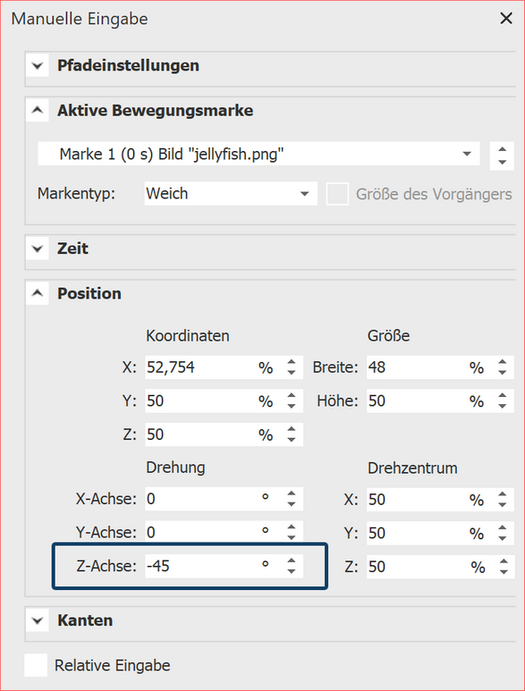

![]() Manual entry of the angle If you have a specific value for the angle of rotation you would like to apply, right click on the image in the Layout designer. From the context menu that appears, select the item manual entry, this will open a corresponding window. Under rotation you can now enter your own preferred value for the angle. It is also possible to input negative values. 4. Further possible applicationsYou can learn how to rotate an object inside a motion path in the chapter "Motion paths with rotations". If you would like to rotate text, you can find precise instructions in the chapters "Rotating texts" and "Making text fly". There are many objects which you can rotate. Rotate videos, flexi-collages, texts, motion paths and images. |
