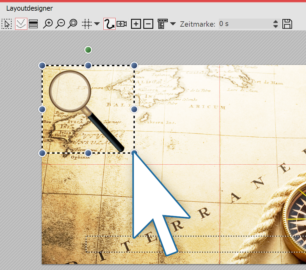

2. Zooming out![]() Shrink the image in the Layout designer Since the magnifying glass is still reasonably large, you can shrink it to allow more room for movement. |

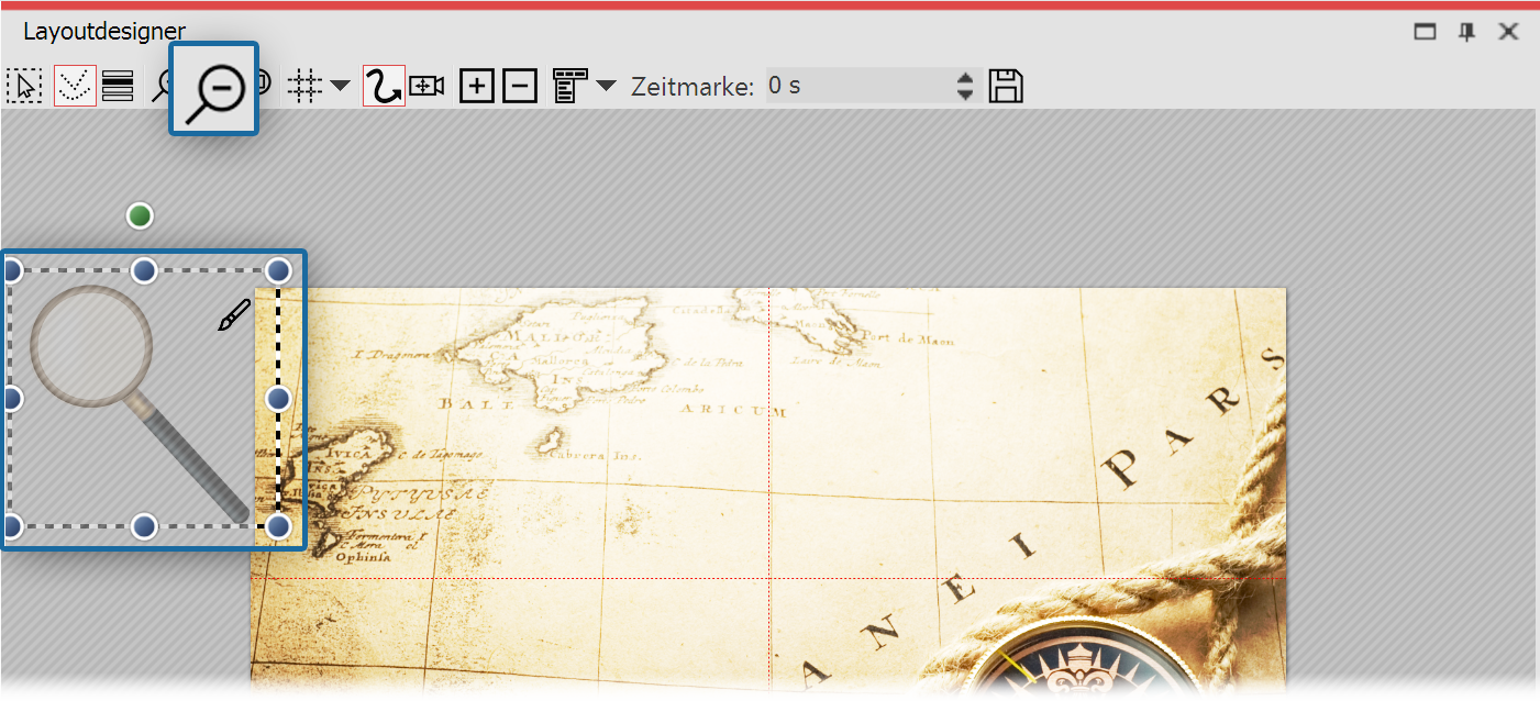

3. Positioning of the first motion markerThe magnifying glass should travel across the image from left to right. In addition, the non-visible range is used. To get better access to this, zoom out by clicking the minus magnifying glass icon. Now drag the image to the left side of the non-visible range. This is the first motion marker. ![]() The first movement marker is located in the non-visible range |

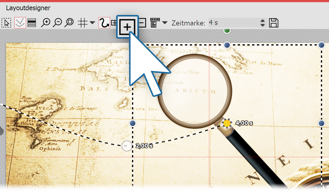

4. Enlarging new motion markers![]() Creating new motion markers Now create the next Movement marker with the squared plus icon. The magnifying glass moves to the right and becomes larger. |
5. Complete motion pathWith the squared plus iconinsert further Motion markers. Enlarge or reduce the image now by each marker to a small piece, depending on how it fits best. |
