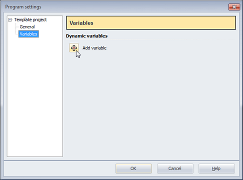

2. | Click on "Variables" on the left side of the dialog.
Now add variables to the template by clicking the button.
![Variableneinstellungen](variableneinstellungen_zoom80.png) |

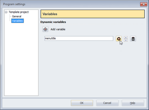

3. | Then type a name for the variable:
![Variableneinstellungen 1](hmfile_hash_567a397d.png) |

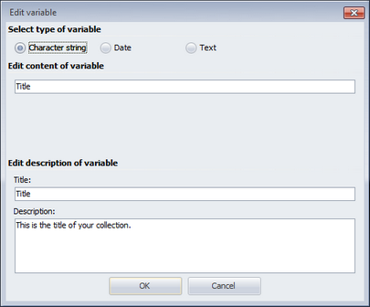

4. | Click the button to adjust other settings for the new variable.
In the dialog you specify of which type your new variable is.
![Variableneinstellungen 2](hmfile_hash_2da291da.png)
The following types are available: |
• | String
This is a single-line text. Use this type for short text like titles, captions, etc. |
• | Date
This can be any date. |
• | Text
This is a multi-line text for any purpose.
Specify the name for the variable that shall later be displayed in SlideShow-Manager's customization menu. If you don't specify anything the name that you chose when creating the variable will be displayed.
Additionally, you can type a description for the variable that will be displayed in the customization menu, as well. |
