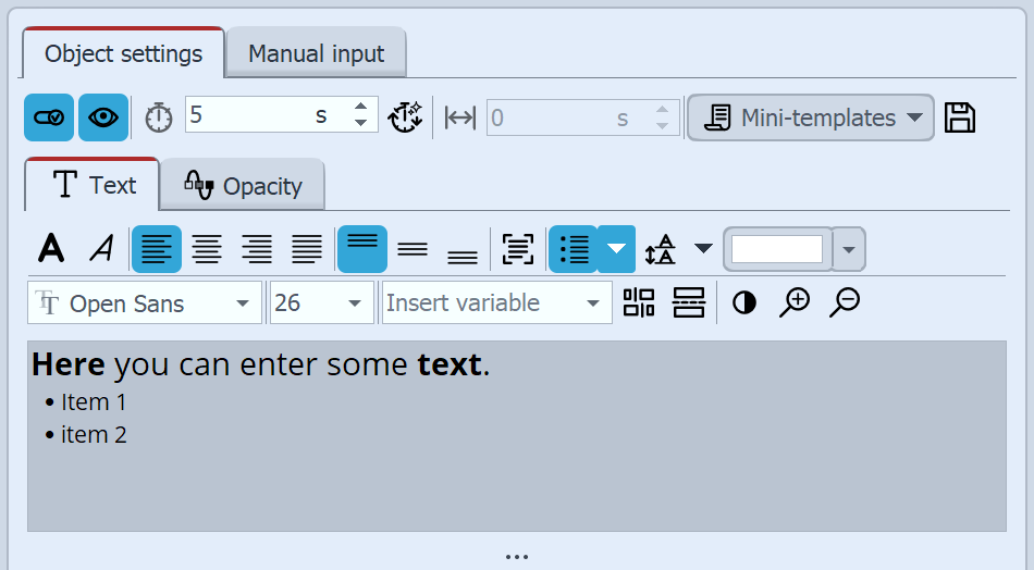

2 Enumerations and numbering
List style
Enable list style
For additional formatting of text you will find at the List button the possibility to use bullets and numbering in a list.
Select the desired type of display. Clicking Enter in the text field adds another enumeration. The color of the markers results from the text color.
To end or remove a set enumeration or numbering, press the button again so that it is unchecked or select None from the drop-down list.

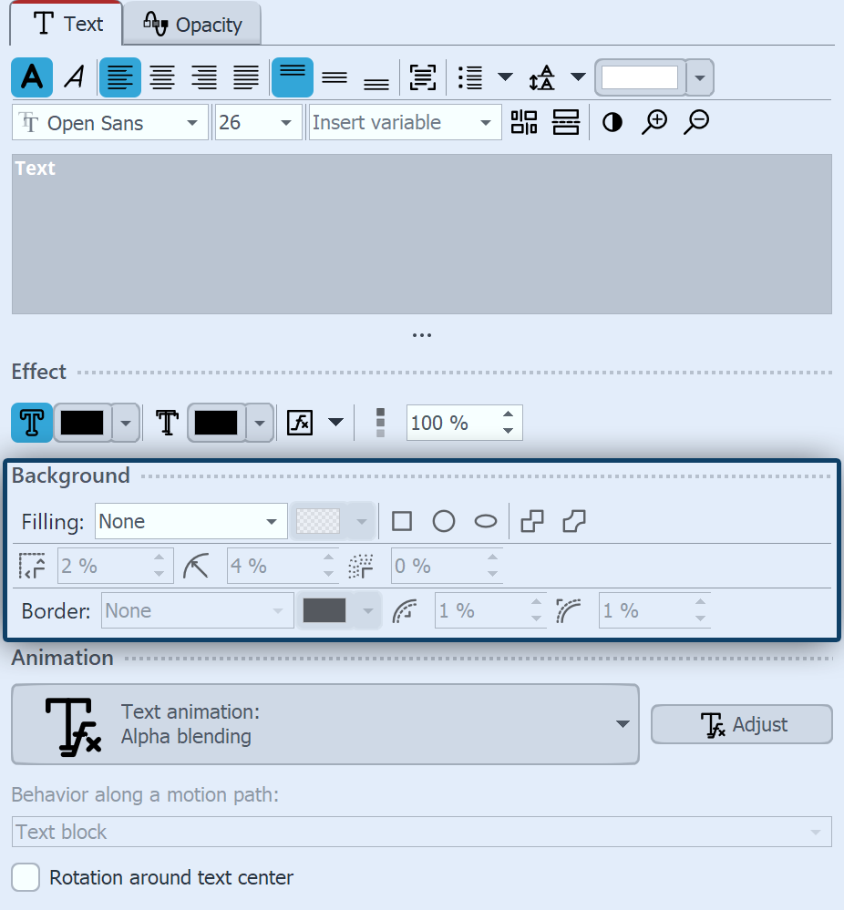

5 Add background to text
In the text properties, you can add a background directly to the text. This makes it easier to read in front of animated images and videos and can be used as an independent stylistic device.
Depending on the setting, the text can be highlighted with a single color or with complex shapes, either with or without a border.
Settings for text background

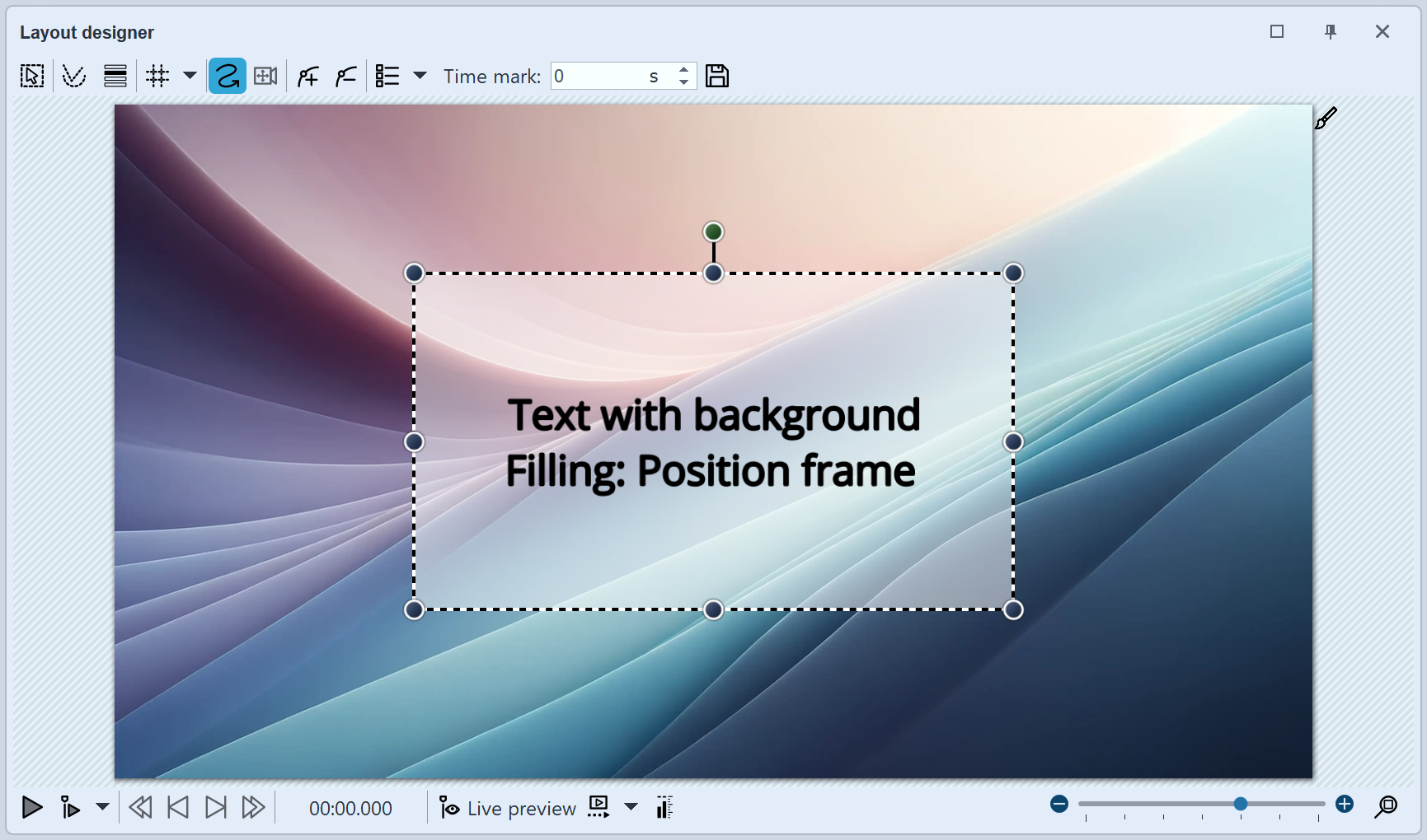

Settings for the filling
By selecting a fill type, your text is highlighted in color. Once a fill type has been selected, the desired color can be set in the color selector. This color can also be semi-transparent.
Without: Text has no background
Position frame: complete selection frame is filled
Complete text: Color field up to the outermost edge of the letters

Various shapes (rectangle, circle, ellipse) are available for the text background.

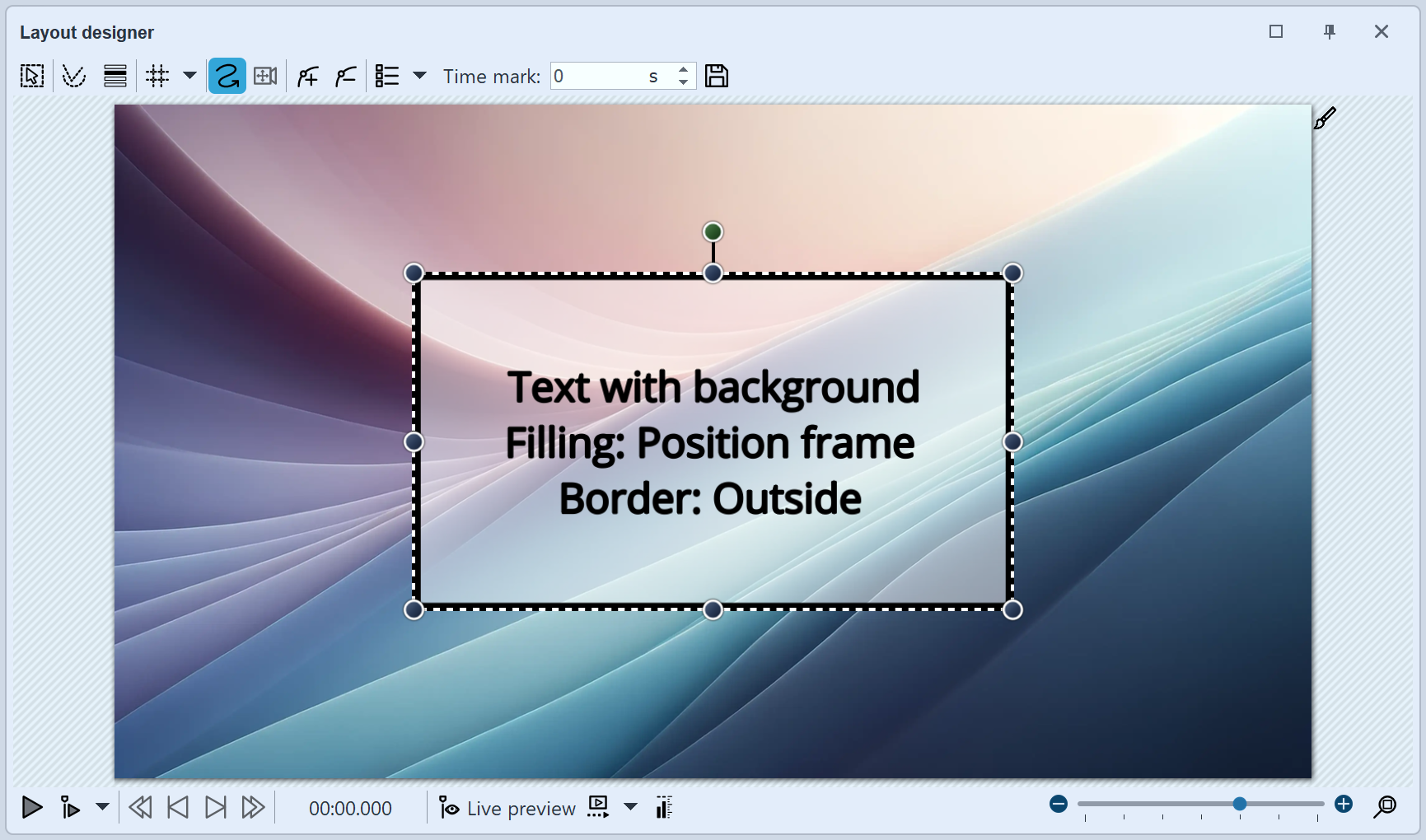

Settings for the border
Select whether and how the filling should be provided with a border.
Depending on the selected setting (None, Inside, Outside, Center, User defined), the width of the inner and/or outer border can be defined.
Use the color picker to define the color for the border of the text background.

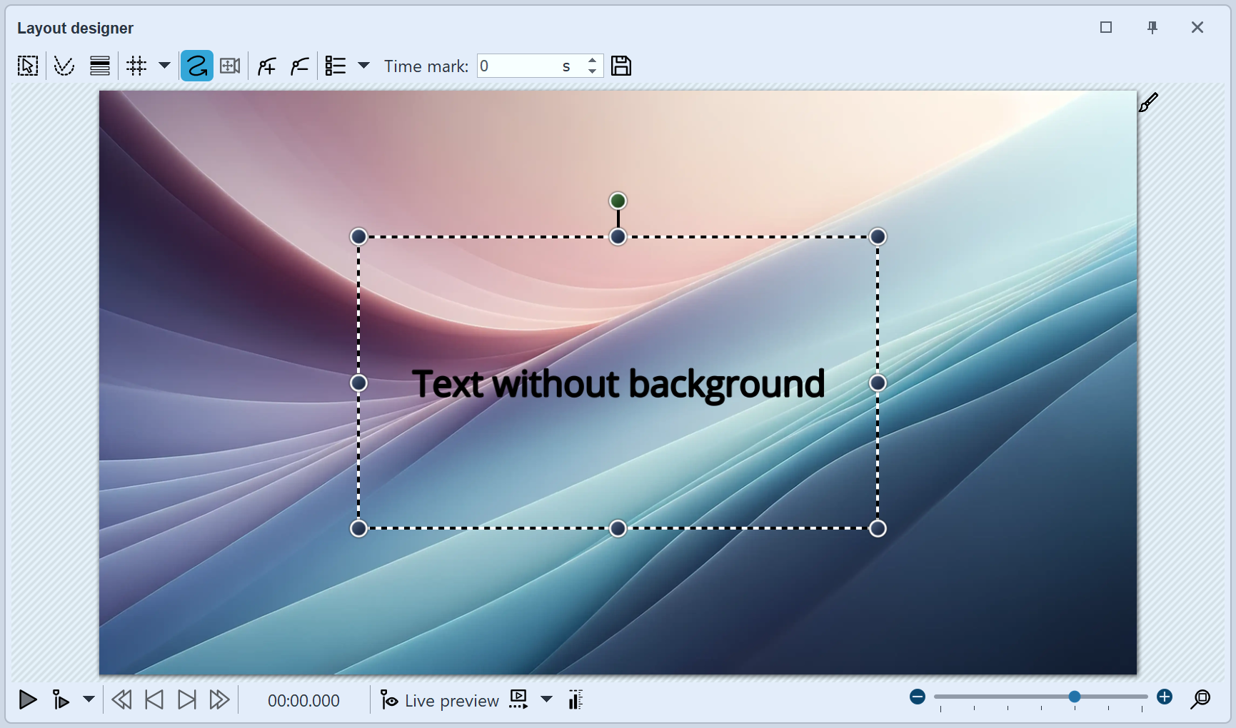

Text without background fill
Text with position frame fill
Text with fill variant "Position frame"

Text with position frame fill and border
Text with fill variant "Position frame" and border "Outside" (selection frame drawn smaller)
