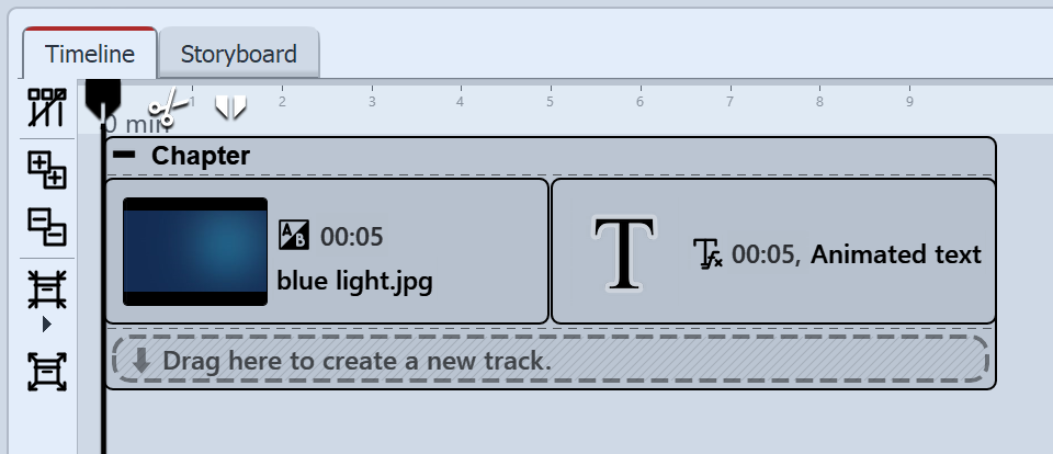

1 Insert your text

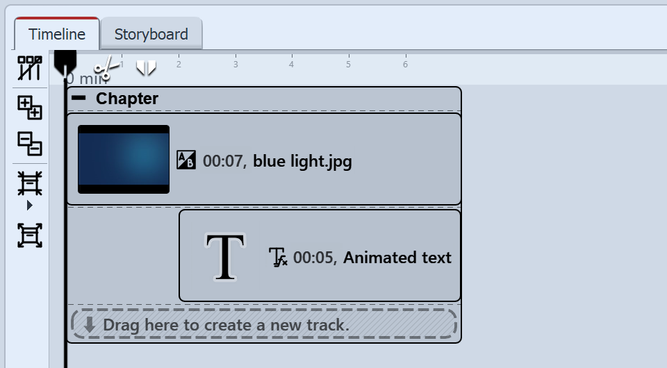

Drag a text object from the Toolbox into the Timeline. An image should be located in front of the text object in the Timeline. You can also work with several tracks (see the instructions in the chapter "Working with multiple tracks").
Text follows image
Text follows image
Text track below image

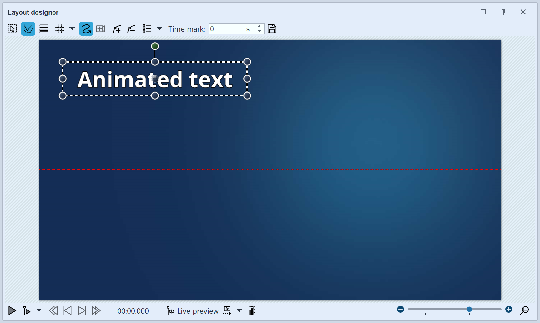

Click on the text object in the Timeline. You will see the text object in the Layout designer. It will be surrounded by a dashed border and some round dots. Move the cursor over the text and move the text with the mouse, holding down the mouse button to do so. This means you can position the text as you wish.
Via the preview image in the Layout designer you will find various icons that will let you create your animation.

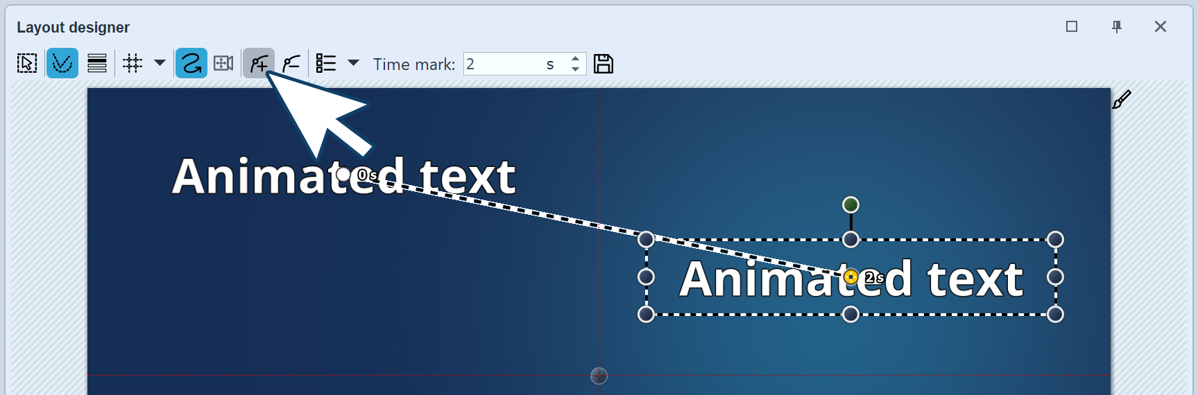

Add a new motion mark by clicking on the square plus symbol in the Layout designer. Now you will be able to see your text in its first position and also at its second position. The second text, or rather the second motion marker is now active. You can move and resize them in the Layout designer. The motion marker, that is already active is indicated by an orange dot. All motion brands that are not currently highlighted (or active) are displayed in a slightly transparent white.

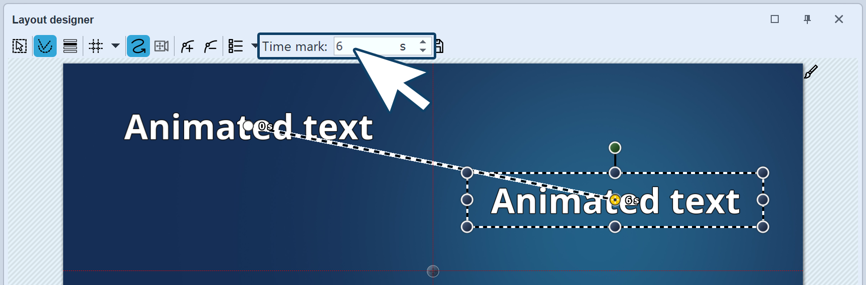

While the second motion marker is still selected (orange dot), enter a different value under time stamp. To slow down the movement between the first and second motion marker, you can increase the value to five seconds. When you increase the value of the first motion marker (default is 0.00s), you can adjust the start time of the movement to your preferred time. The times of the other motion marks will be automatically adjusted accordingly with the value of the first motion marker added on.

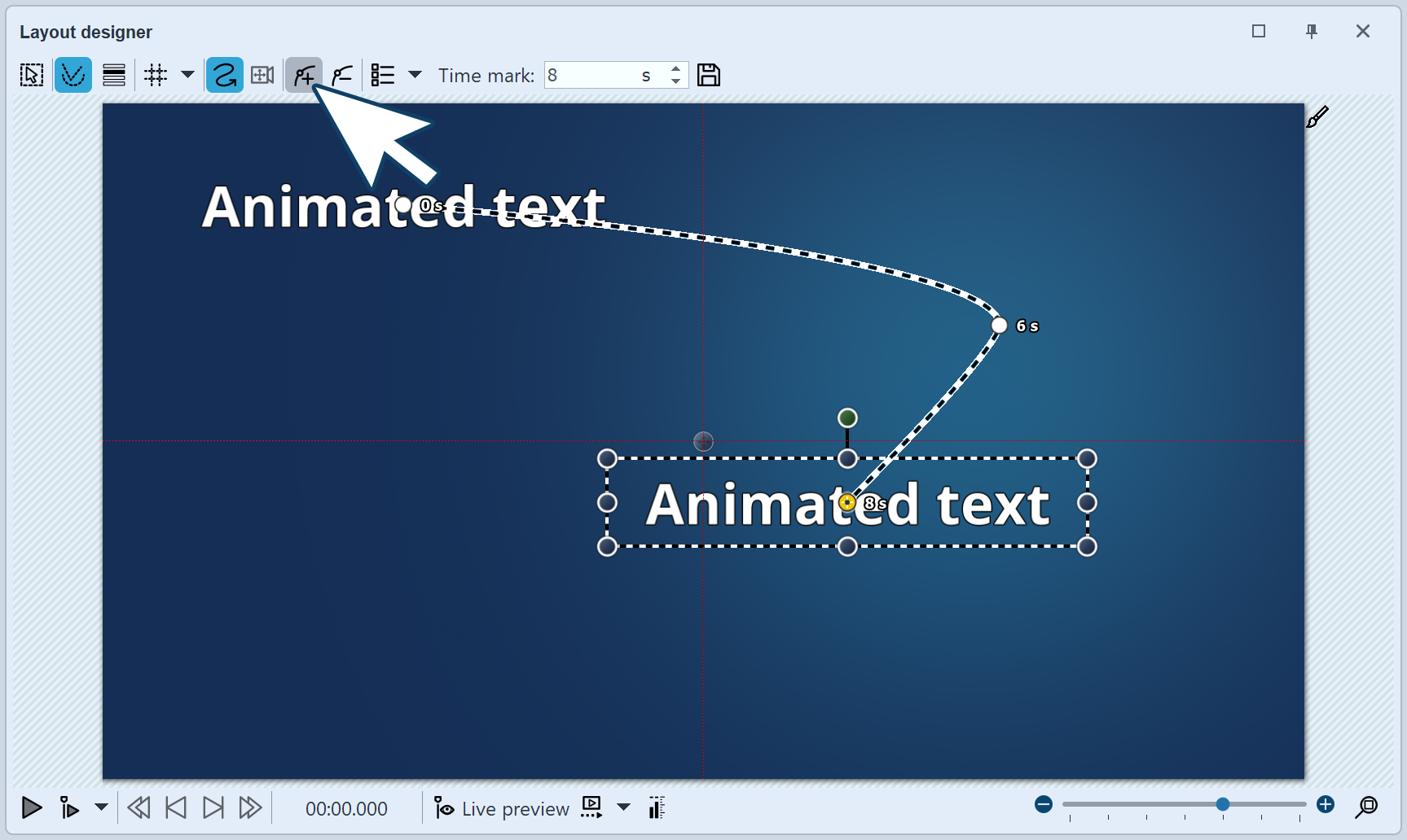

Now use the squared plus symbol to add a new motion marker. Position the motion marker at the top right. Using the round drag handles, you can shrink the text. It will then seem as though the text is “flying” backwards. To preview this, activate the preview in the Layout designer or press  f9  .

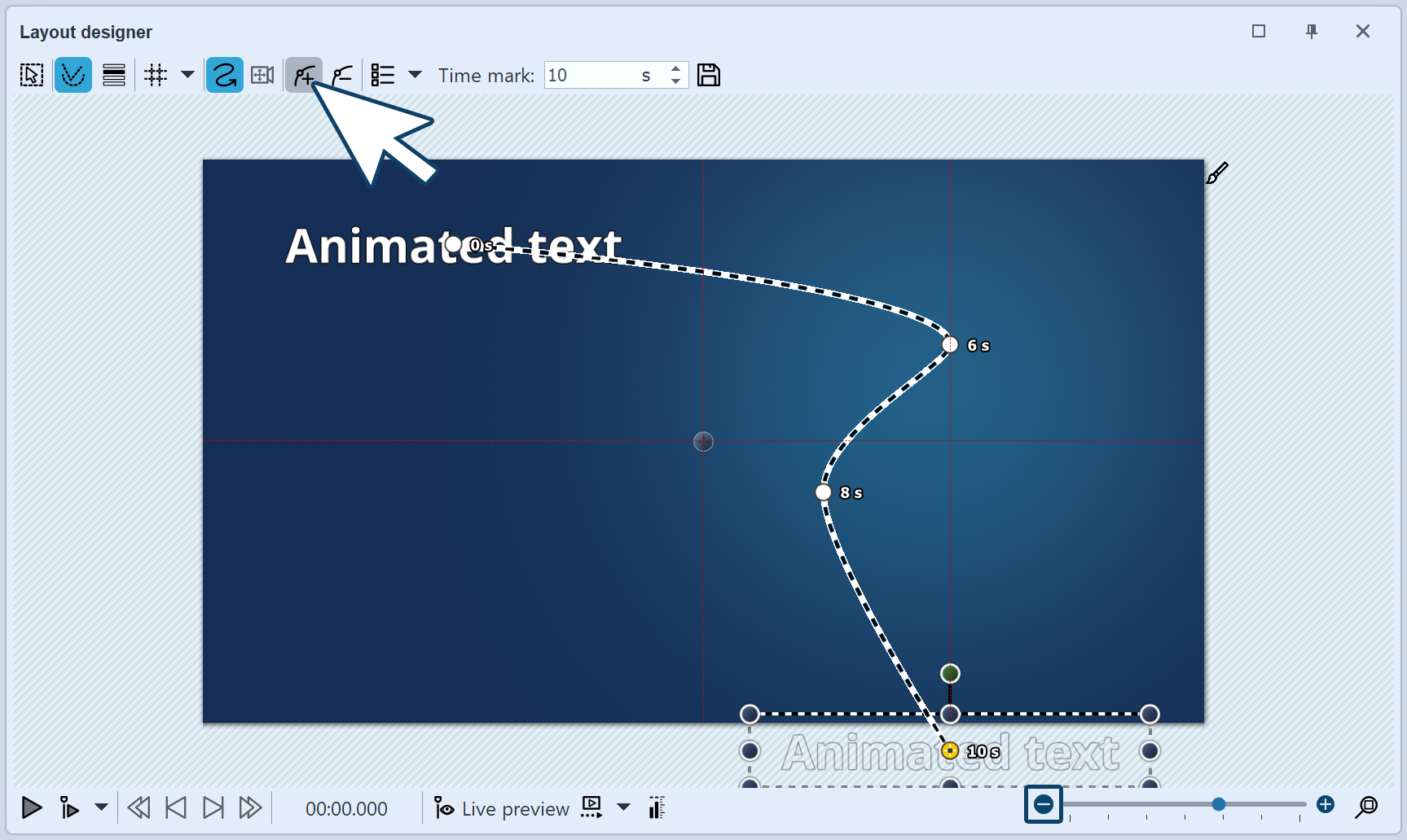

You can also position motion marks in the non-visible area. This will allow the text to “fly” out of the image and then disappear. Add a new motion marker with the squared plus icon. Use the minus magnifying glass icon to zoom out of the view in the Layout designer. You have now shrunk the visible area in the Layout designer and you will find a larger gray area around the preview image. This area is not visible to the viewer of the final presentation and so, any objects within it, are considered invisible. Move the newly added motion marker into the non-visible area, allowing the text to “fly” out of the picture.
