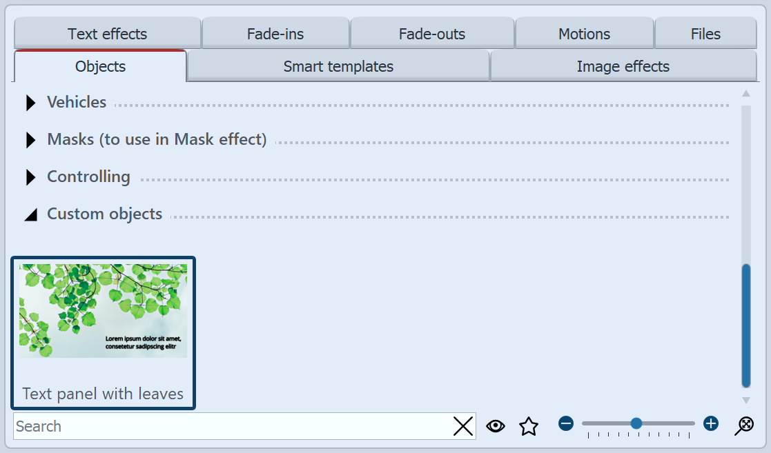

Custom object in the Toolbox
You will then find the created template in the Toolbox under Objects / My Objects. To insert further images with the same formatting, simply drag the saved template from Toolbox into the Timeline or image list with the mouse button pressed. The dialog for inserting the images will open. Now select the images to be inserted with the settings of the saved template. The inserted images now have the saved formatting and do not need to be adjusted.
