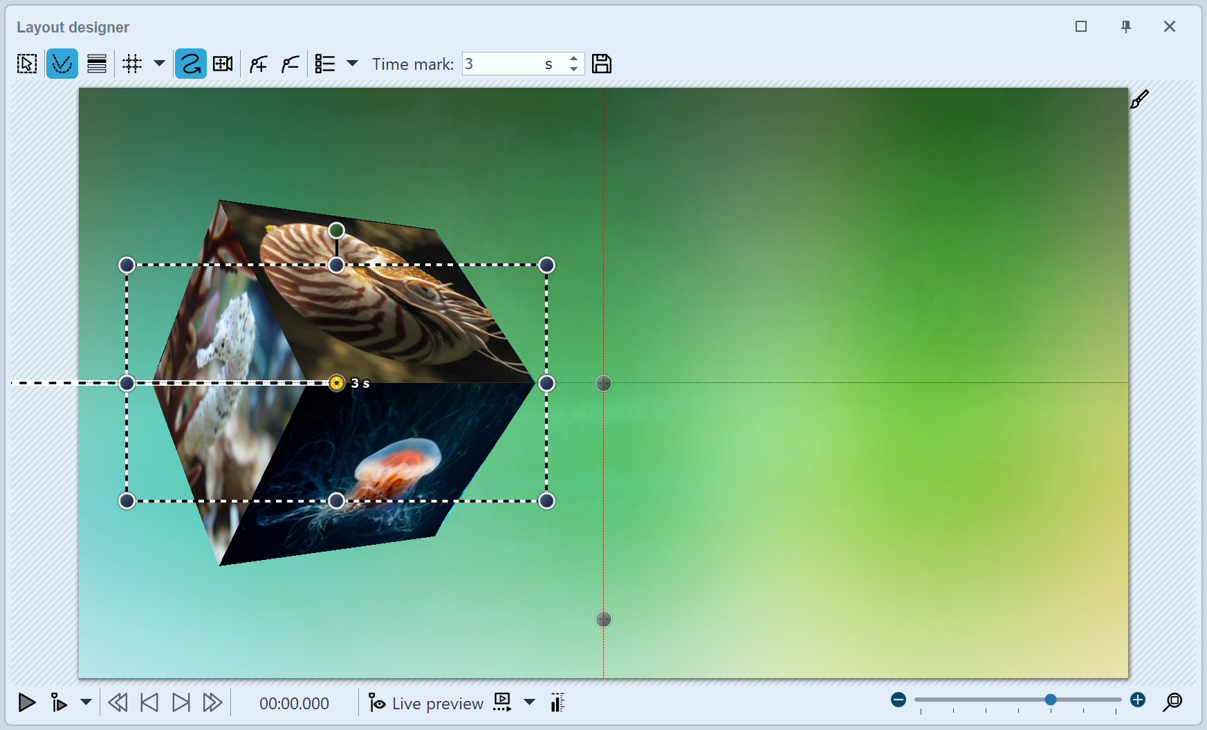

Size and position of the 3D cube
To shrink the cube, first select the effect frame in the Timeline. Then, in the Layout designer, in Motion path mode, drag the dashed selection frame smaller by a handle.
You can also move the position of the cube in the Layout designer in Motion path mode, or additionally apply a motion path to the cube.
Design view
Effect 3D cube in layout designer
Reduced 3D cube in Layout designer with motion path
