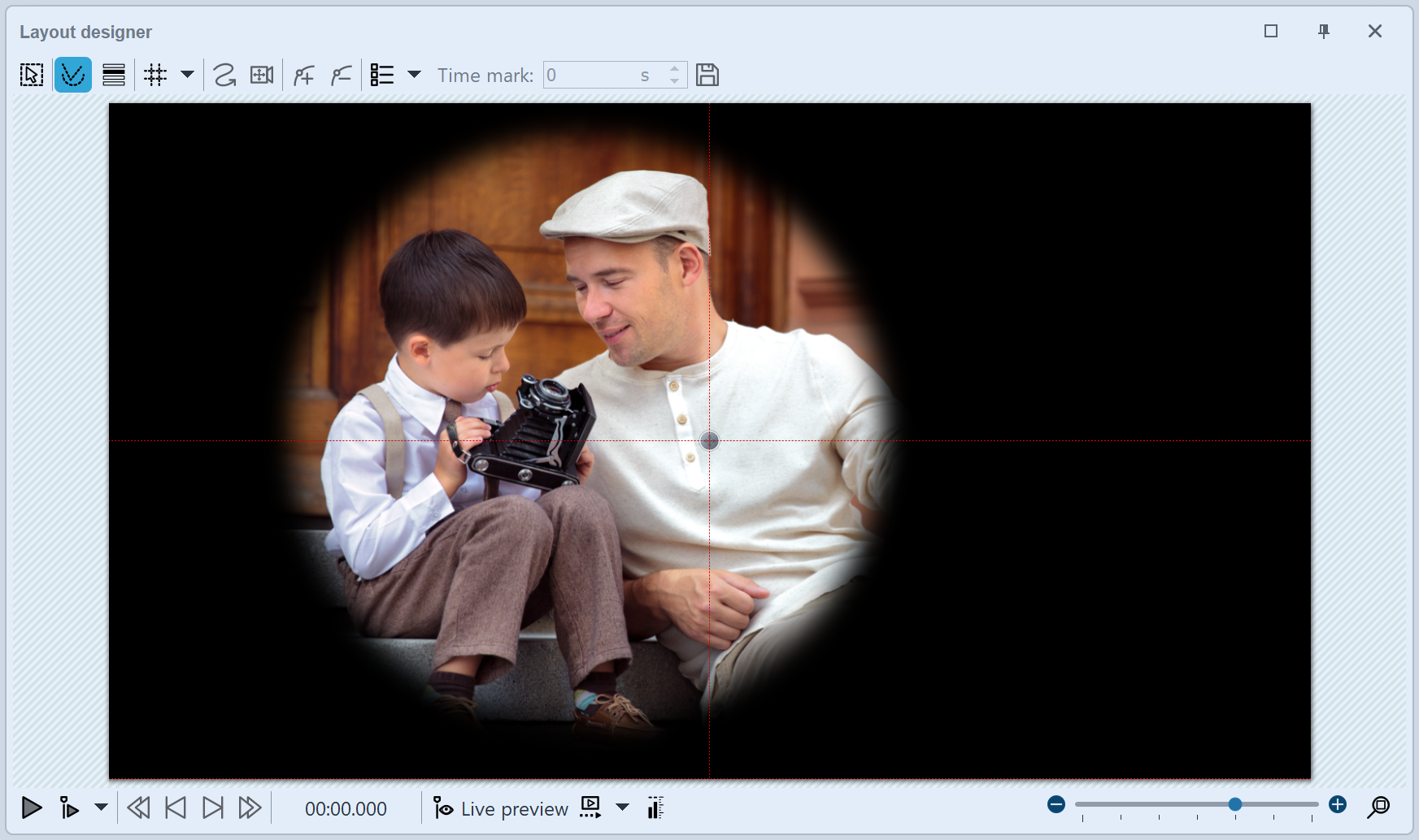

![]() Dynamic mask You can find the Dynamic mask effect in the Toolbox below the tab Objects in the section Live effects. A mask defines the area of your image that is visible or invisible in the presentation. This means that the mask can take any form and be of any size. It further means that a text, an image, videos, Flexi-Collages as well as a chapter can be a mask. The mask effect is dynamic. This means that the masked area can be animated and can thus change the flow of the presentation. Example: Everything that is black and white can be a mask - also pictures in shades of gray are masks. The Dynamic mask effect ensures that the image, which is located in a track above the mask can be seen within the field, where the mask is white. The rest is covered by the mask. |

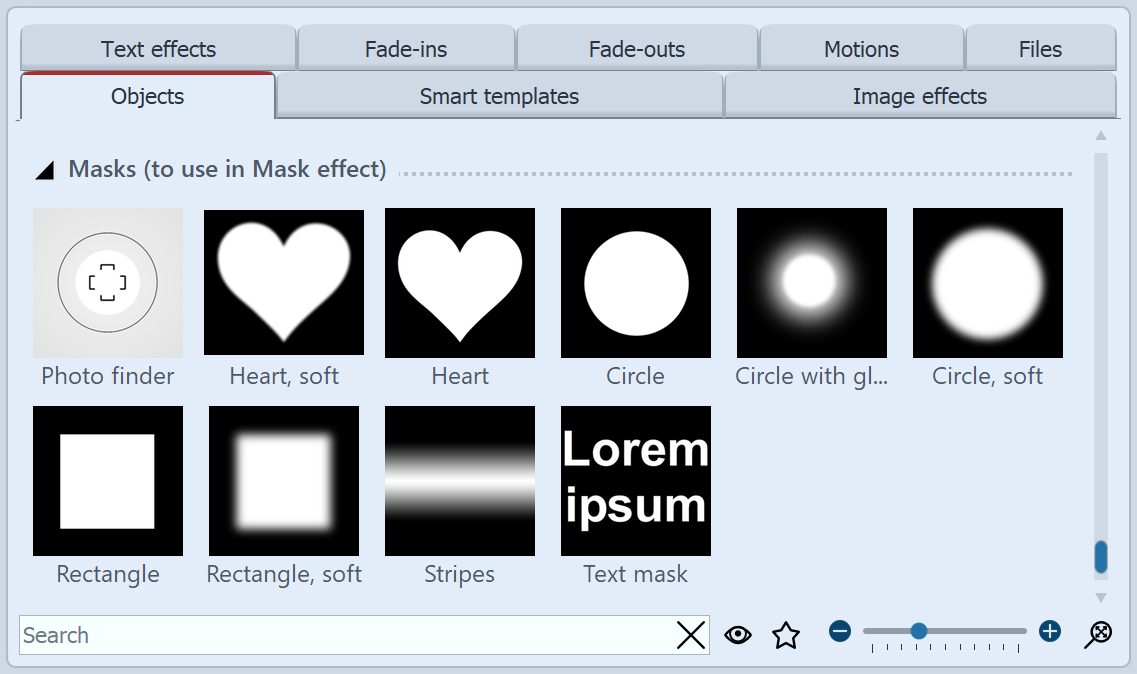

1 Insert the "Dynamic mask" effect![]() Dynamic mask effect in the timeline Drag the Dynamic mask effect from the Toolbox into the Timeline. Should the effect not have opened as per the example picture, you can click on the small plus, that is located in front of the lettering Dynamic mask effect in the Timeline. Now you will see two fields: •Content: Here you add the objects on which you want the mask to have an effect. •Mask: You insert the mask here. For this you can use ready-made graphics from the Toolbox, which you can find under the tab Objects tab in the Masks section. |
2 Placiea mask in the Layout designer ![]() Masks from the toolbox A mask has a white and a black area. The area which in the mask is white, leaves visible the object which you have inserted under Content. There are several display options, help you to place the Dynamic mask effect properly. |

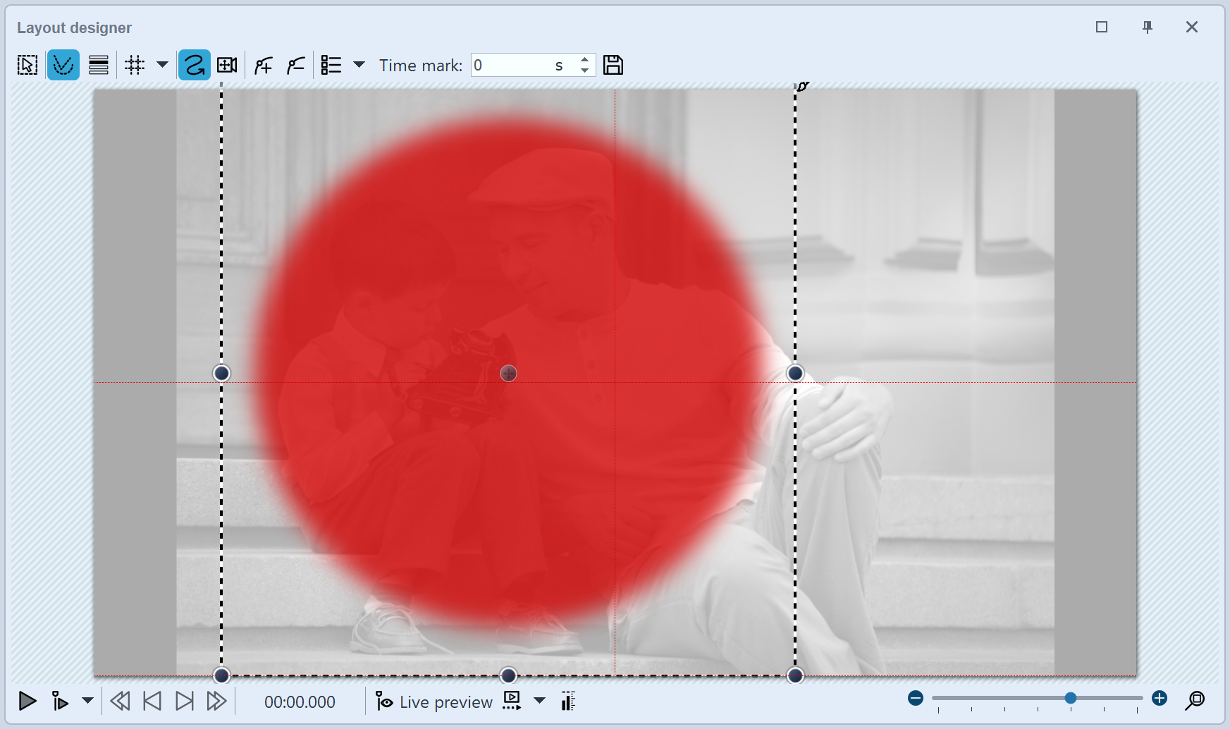

![]() Yellow frame of the effect has been clicked on The yellow frame of the effect has been clicked on: |

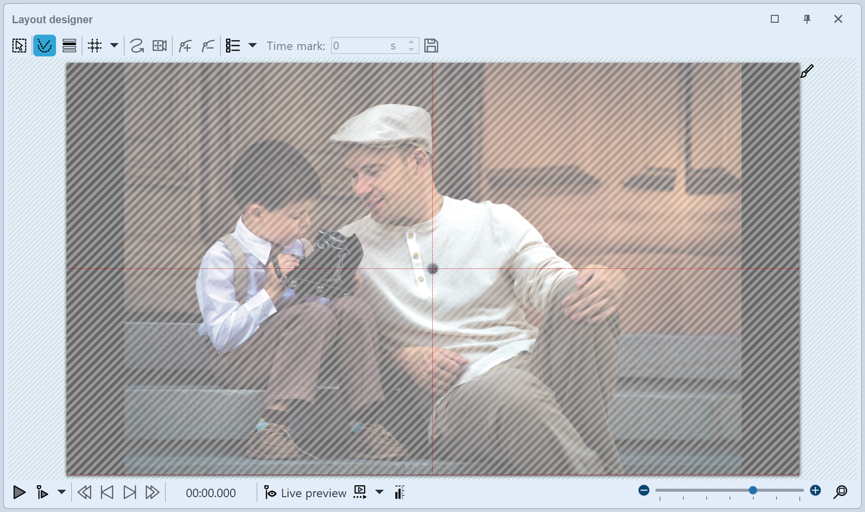

![]() Content area of the effect has been clicked on The content area has been clicked on: |
![]() Mask area of the effect has been clicked on Clicking on the mask area: |

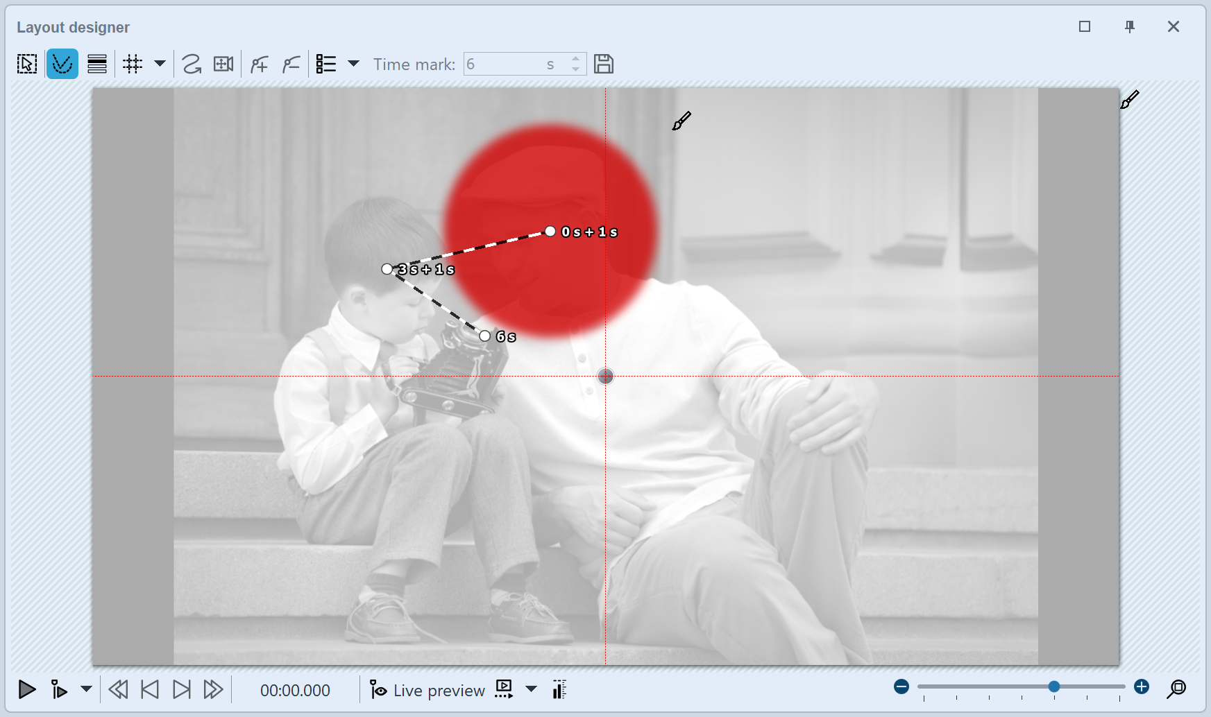

3 Move the mask![]() Mask receives motion path You can add, to each element of the Dynamic mask effect a motion path and a fading in or out, and camera panning can also be used. Select the image that you have inserted into the mask field. In the Layout designer you can now create a simple motion path for this purpose. For information on how to do this, refer to the chapter "Introduction to motion paths”. You have just created your first Dynamic mask effect. You can look at the effect in the preview in the Layout designer. There are many more possibilities - in the next step you will learn about another of them. |

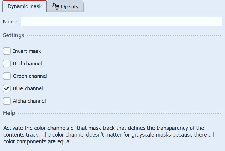

5 Settings of the effect![]() Settings for the "Dynamic mask" effect If the entire Dynamic mask effect is selected, find further setting possibilities in the Properties window.
