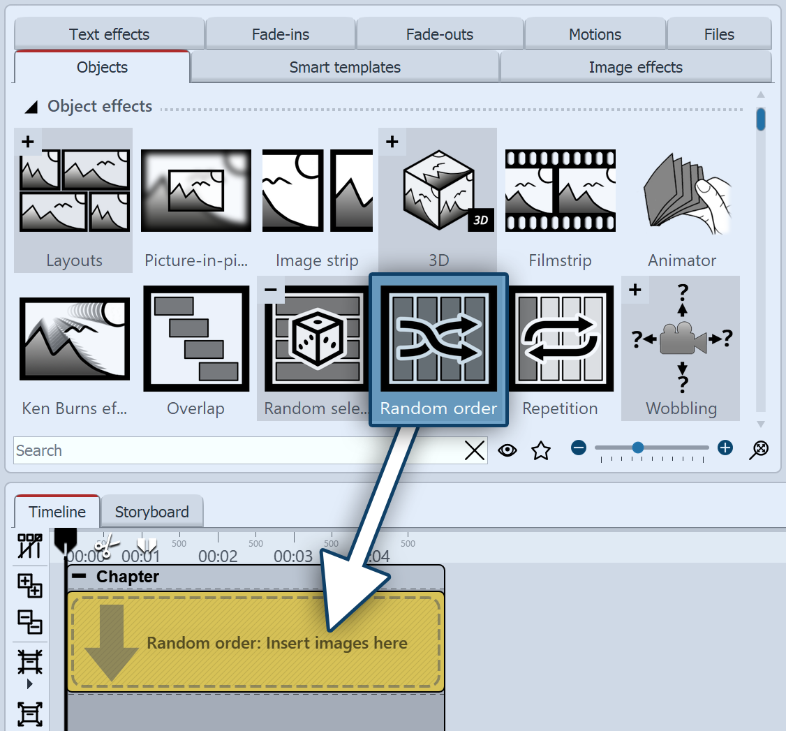

1 Insert a "Random order" effect
![]() Insert "Random order" effect Drag the Random selection effect from the Toolbox to the Timeline. In the Timeline you will now see a colored box. Insert your images or videos here. To do this, get the image or video into the Timeline using the Toolbox Files tab, for example, or drag an image object or video object into the Random selection effect to insert images or videos. Chapter objects or Flexi-Collages can also be inserted. In the Random selection effect, the contents are arranged one after the other. During playback, all contents, i.e. photos, videos, chapter objects or Flexi-Collages are played back in random order. |

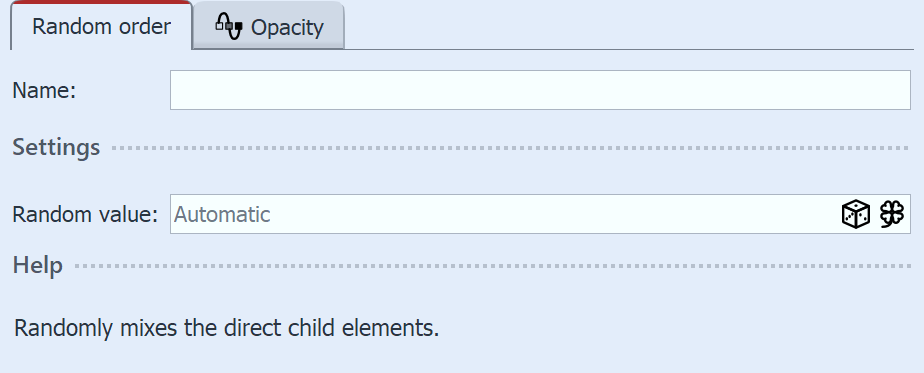

![]() Settings for "Random order" After you have inserted the effect, click on the colored effect frame in the Timeline. In the Properties area, you can now see the adjacent properties. If the Random value field is set to Automatic, the order in which the content is shown will be decided each time the effect is played. |
