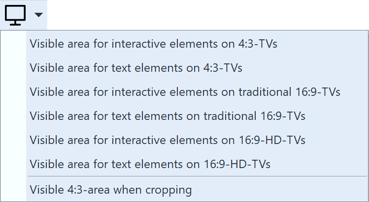

5.TVs, and especially more old-fashioned models, have an area at the edges of their screen where the correct display cannot be guaranteed.
You can adjust these areas by using the menus to fade them in or out.
Visible areas
6.It is also possible to fade in the part of the template that would be cropped in the 4:3 format.

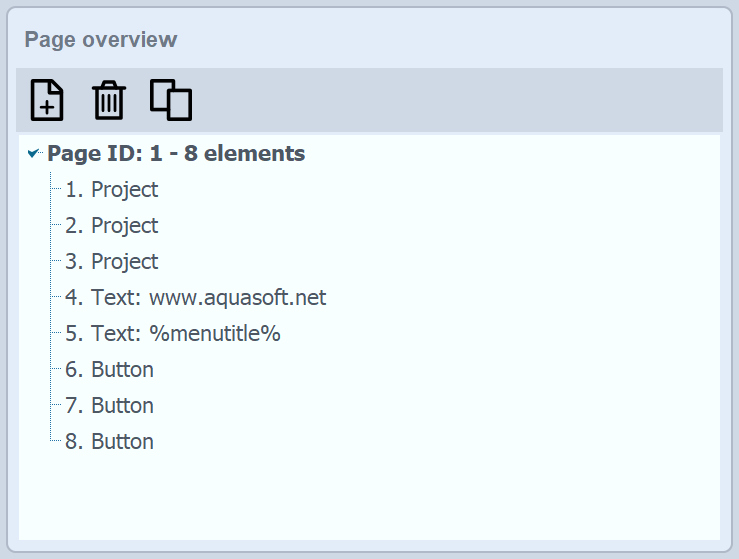

8.Make sure that buttons and project placeholders are located above all other non-interactive elements and are not covered by any other elements. This allows you to avoid problems when navigating in PC menus. You can place one element over another by dragging it with the mouse into the page structure view underneath the previous element on that page.
