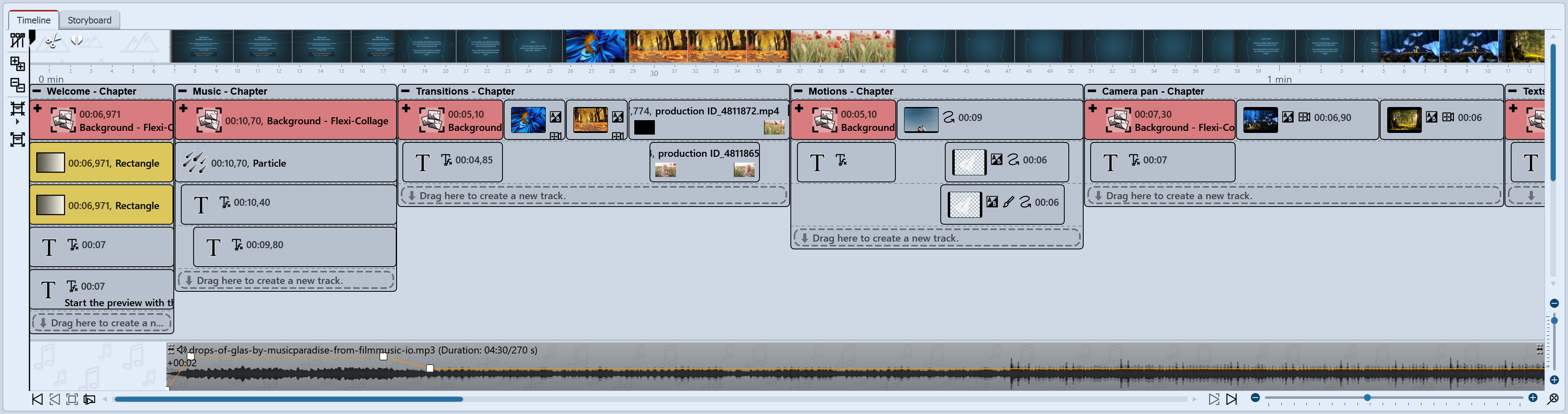

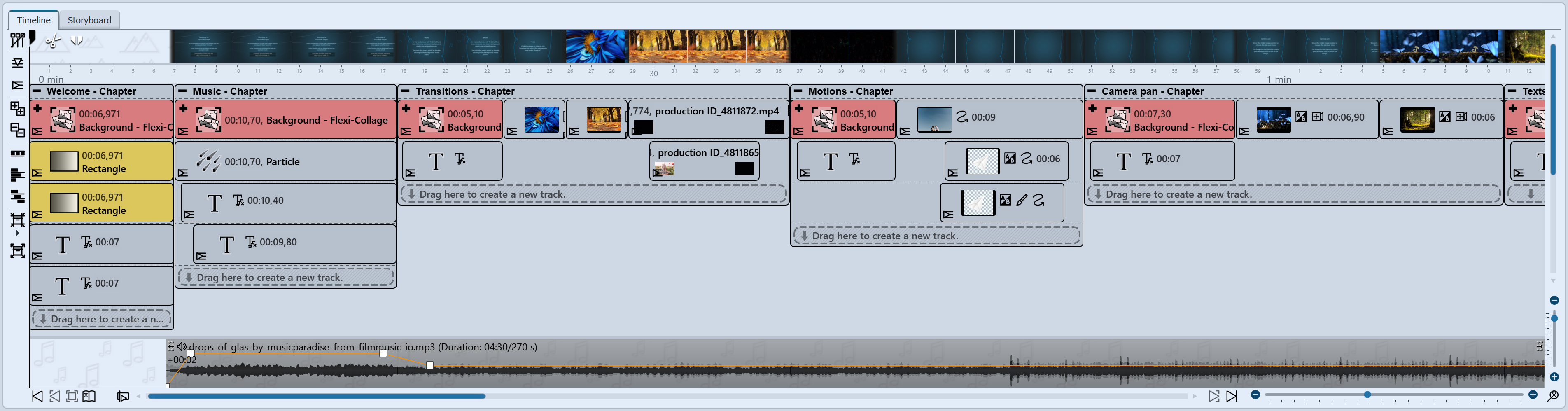

Empty Timeline in Premium When you start the program or create a new project, you will find a Chapter object at Timeline that allows you to start directly with several tracks. You can define how many tracks the start chapter has under Extras / Program settings / Timeline / Chapter tracks. There are specially marked Permanent tracks in this start chapter. You can read more about this in the chapter Properties of objects: Chapter. To learn how to work with multiple tracks, refer to the chapter Multiple tracks. |
Timeline with multiple tracks (Video Vision)
Timeline with tracks and keyframes (Stages)

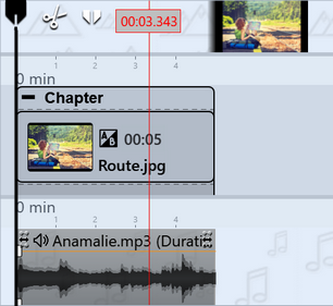

Timeline with marking Press the Shift key and click on the Timeline in the Timeline (see image on the left). A red line appears, which you can move by holding down the mouse button. The line goes over your inserted objects and the background music track. You can also set Timeline markers while the project is previewing in the Layout designer. Always press the Enter key at the time you want to insert a marker. The markers act magnetically to help you align your images in multiple Timeline tracks or match them to music bars. |
