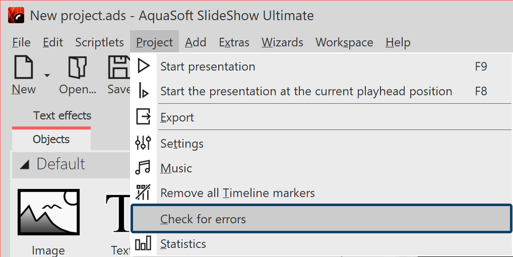

![]() Check project for errors Open your ads file and click under Project /Check for errors.

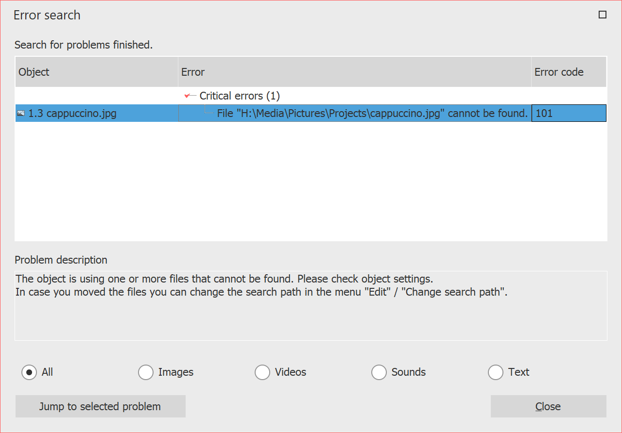

![]() Troubleshooting result with an error display If critical errors are found, you will receive appropriate notices about the problem. To look at the location in your project and fix the error, highlight the error message and click the "Jump to selcted problem" button. After fixing the error you can start a new error check. If several images cannot be found, the Find files Wizard will help you. |

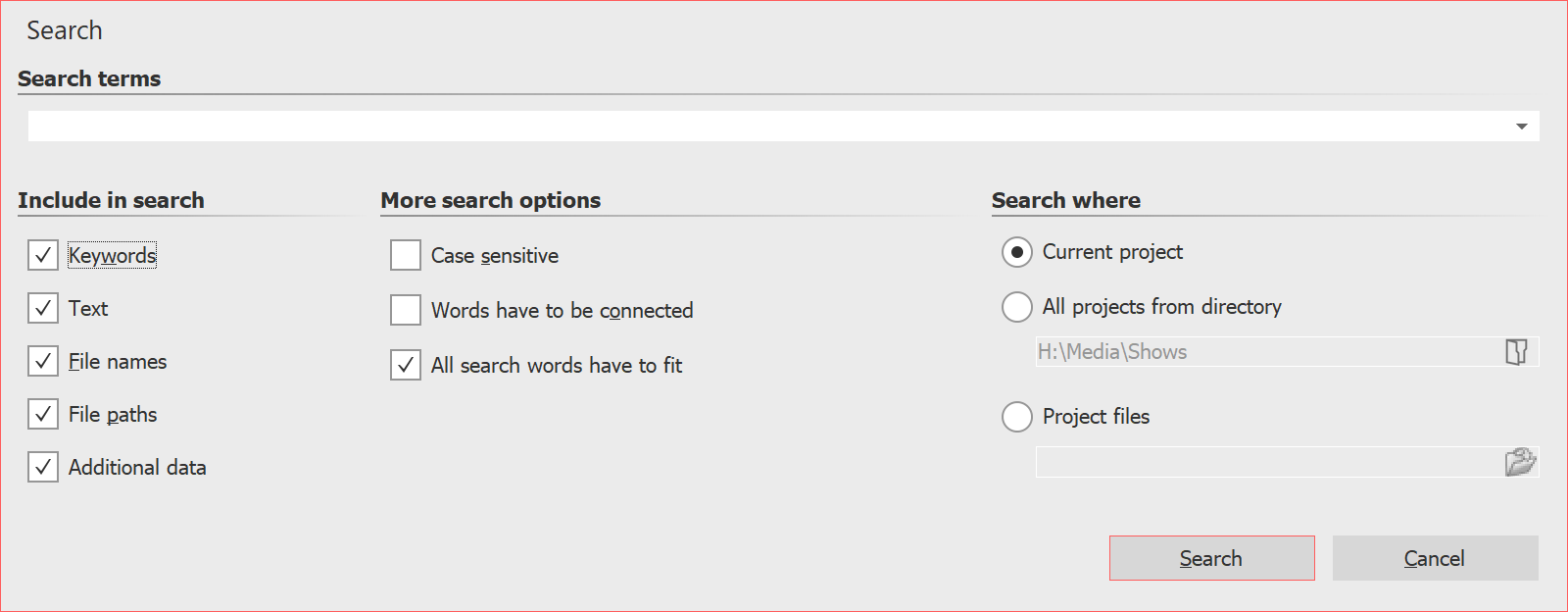

![]() Search function In the Toolbar or in the Menu bar under Edit / Search you will find the search function. This allows you to search for texts, file names, file extensions and keywords in your projects. It is particularly useful for correcting typos in image captions, for example. |

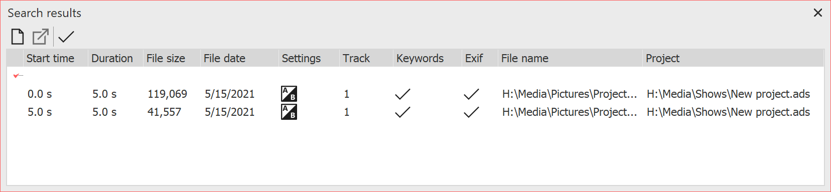

![]() Search results In der Suchergebnis-Liste bekommen Sie die Treffer mit der Startzeit angezeigt. Mit dem Häkchen-Symbol lassen sich die Treffer im Projekt markieren. |
