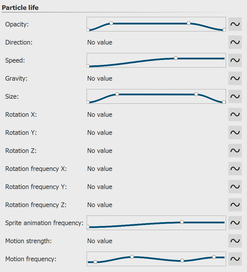

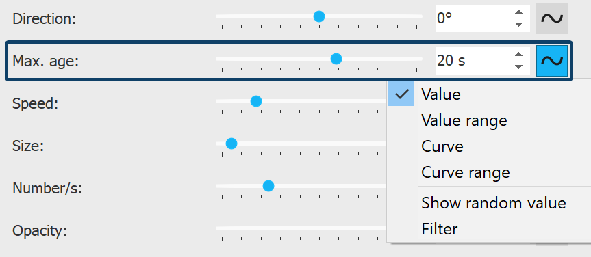

A particle can change over its lifetime. It can become larger or smaller, faster or slower, more transparent or denser - other settings and their combination with each other are also possible.
![]() Set lifetime 1 Set lifetime In the Object settings area, you first set how high the maximum age of a particle should be. You can enter a simple value, but a range of values and setting via curves is also possible. Setting this value is the basis for all other settings that define the behavior over the lifetime. If this value is not set, all settings regarding the lifetime have no effect. |
