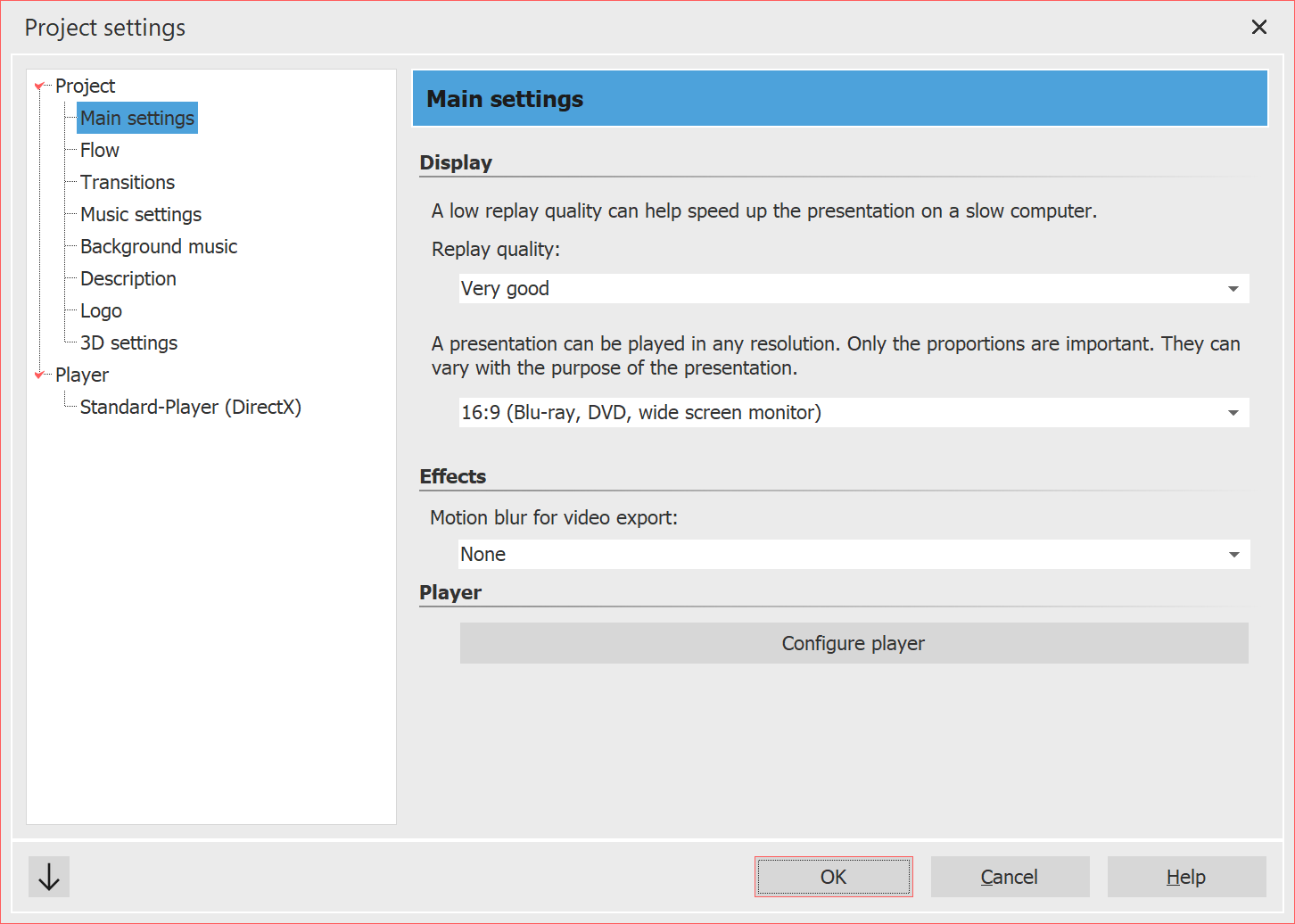

1 Call up project settings
Call up the Project settings via the Settings button in the Toolbar or via the Project / Settings menu. Now select the item Standard-Player from the menu on the left. This will take you to the configuration of the Player.
Standard-Player
Standard-Player

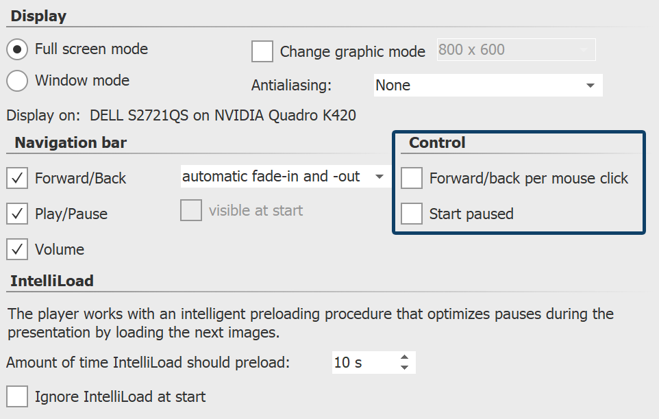

2 Player settings
At the Control item you will find the following options:
Forward/back per mouse click
Only when you click with the mouse or use the arrow keys, the next image appears. The set display duration of the image does not matter.
To activate this function, the "Start paused" checkbox must be set.
Note: Pressing the spacebar in this mode overrides the mouse click control.
Start paused
The presentation starts with a freeze frame, it will not start until you start the presentation manually.
