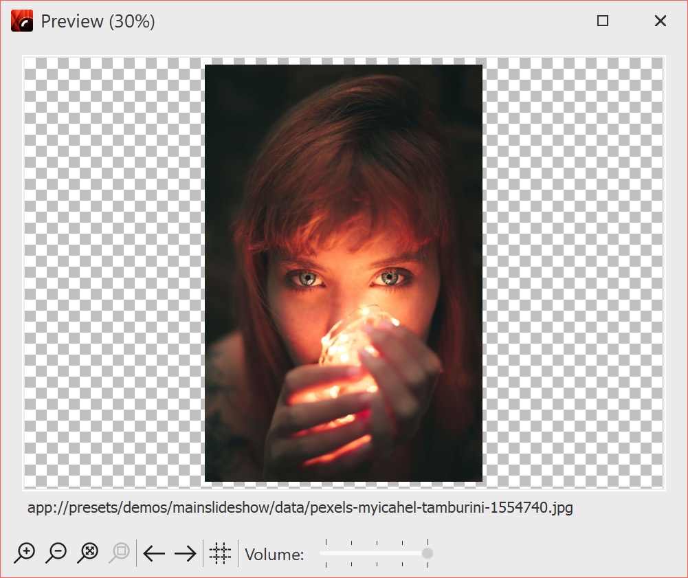

1 Display / Play
Select an object (sound, video, image) in the Timeline by clicking on it. Now you can see and/or hear the preview. In this preview the object is displayed without effects, you see/hear it in its original state. In addition, you can switch to the next object or display several objects at once.
You also get this preview when you double-click an object (sound, video, image) in the Timeline.
