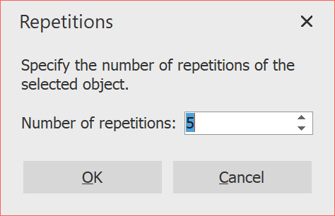

Multiply objects
Multiply objects
Multiply objects
If you want to copy and paste several objects with identical properties repeatedly, a corresponding function is available. Inthis way, even more complex Chapters and Flexi-Collages can be quickly multiplied and pasted one after the other.
To do this, select the object to be multiplied and go to Edit / Multiply and specify the number of repetitions you want.
