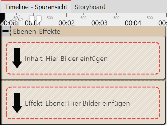

Empty layers effect in the timeline
Drag the effect from the Toolbox into the Timeline.
In the effect you will find two areas: Content and effect level:
In the content field, drag the object to which the effect is to be applied.
In the effect level field, put the image or video, with which you wish to describe the up and down of the effect.
The more contrasting the darks and lights are here, the better the appearance of the overall effect. You can assign individual effects to all the objects which are in this effect, for example, a motion path.
