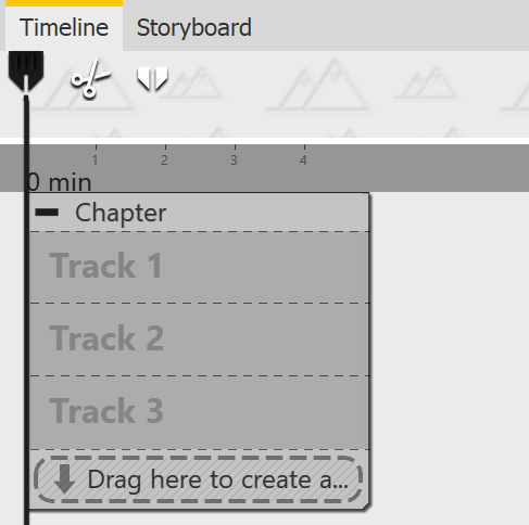

When you start the program or create a new project, you will find a Chapter object at Timeline that allows you to start directly with several tracks. You can define how many tracks the start chapter has under Extras / Program settings / Timeline / Chapter tracks.
There are specially marked Permanent tracks in this start chapter. You can read more about this in the chapter Properties of objects: Chapter.

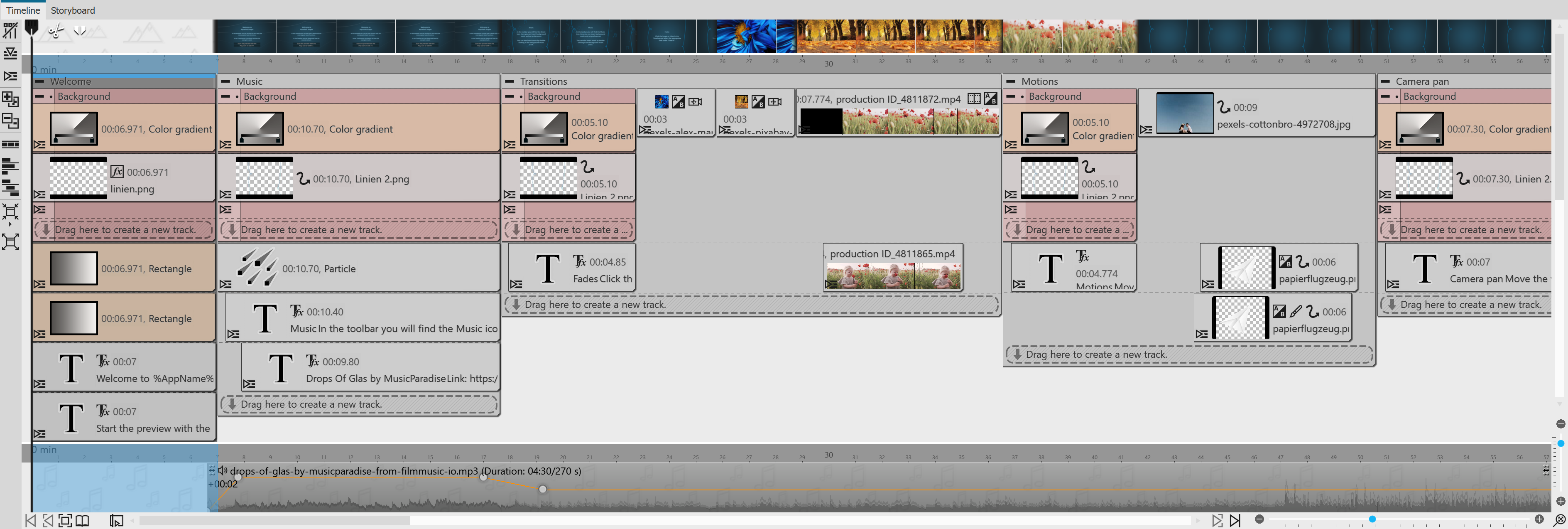

Timeline with multiple tracks (Ultimate)

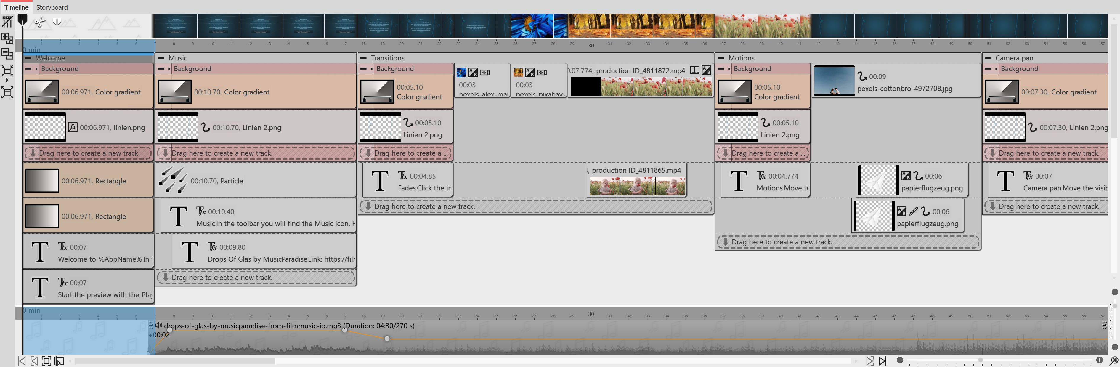

Timeline with tracks and keyframes (Stages)

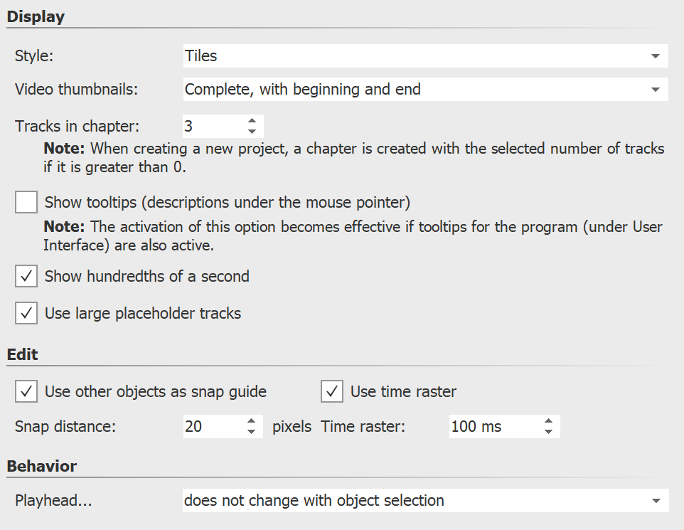

You can influence the behavior of Playheads under Tools / Program settings / Timeline / Behavior.
Settings for Timeline
Under Extras / Program settings / Timeline you can make further configurations of the Timeline.
Here you can change the snap-in behavior and the display in the Timeline. To save space in the Timeline, you can remove the checkmark from "Use large placeholder tracks". This will cause the "Drag here to create new track" hint in chapter objects and Flexi-Collagen to be displayed only minimized.
